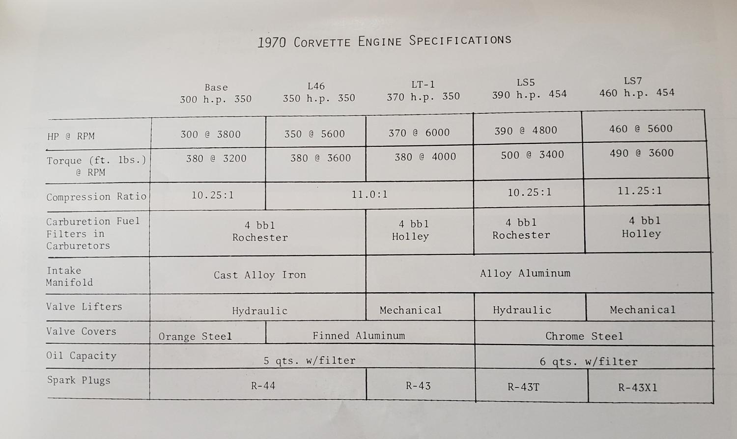

	I'm helping out a friend with a few projects on his 70 Vette. Right now he has aftermarket aluminum valve covers on it. I've searched on line a bit and would like to know definitively if it has the finned aluminum valve covers or stamped steel covers painted orange. Thanks. Phil Woj  |
			----What horse, Woj???....Bill S
			Oops.  It's a 350/300hp.
			From MF Dobbins book.
