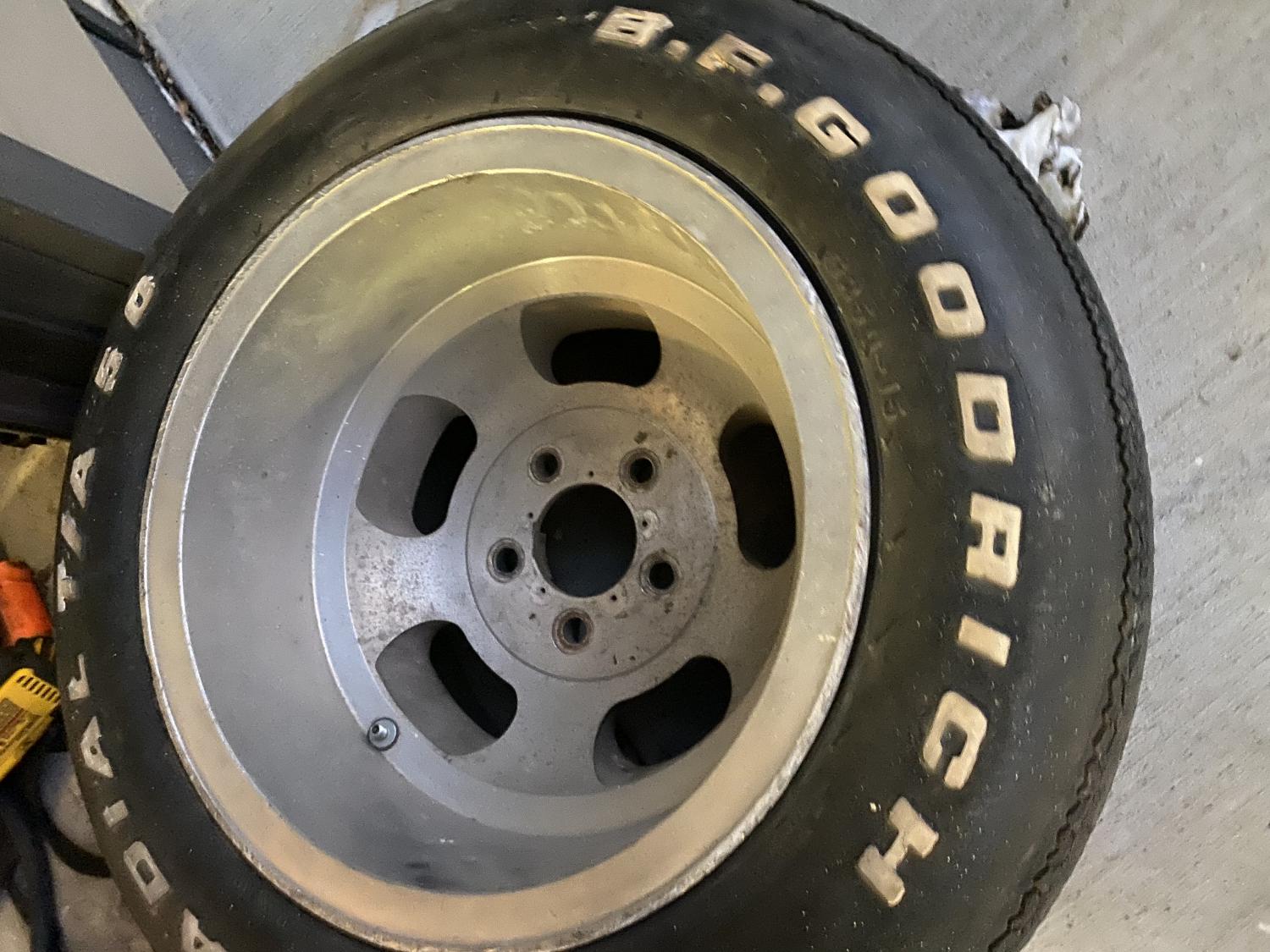

Here is the front rim off the car.

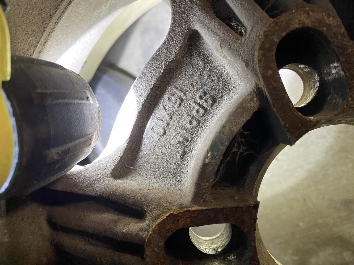

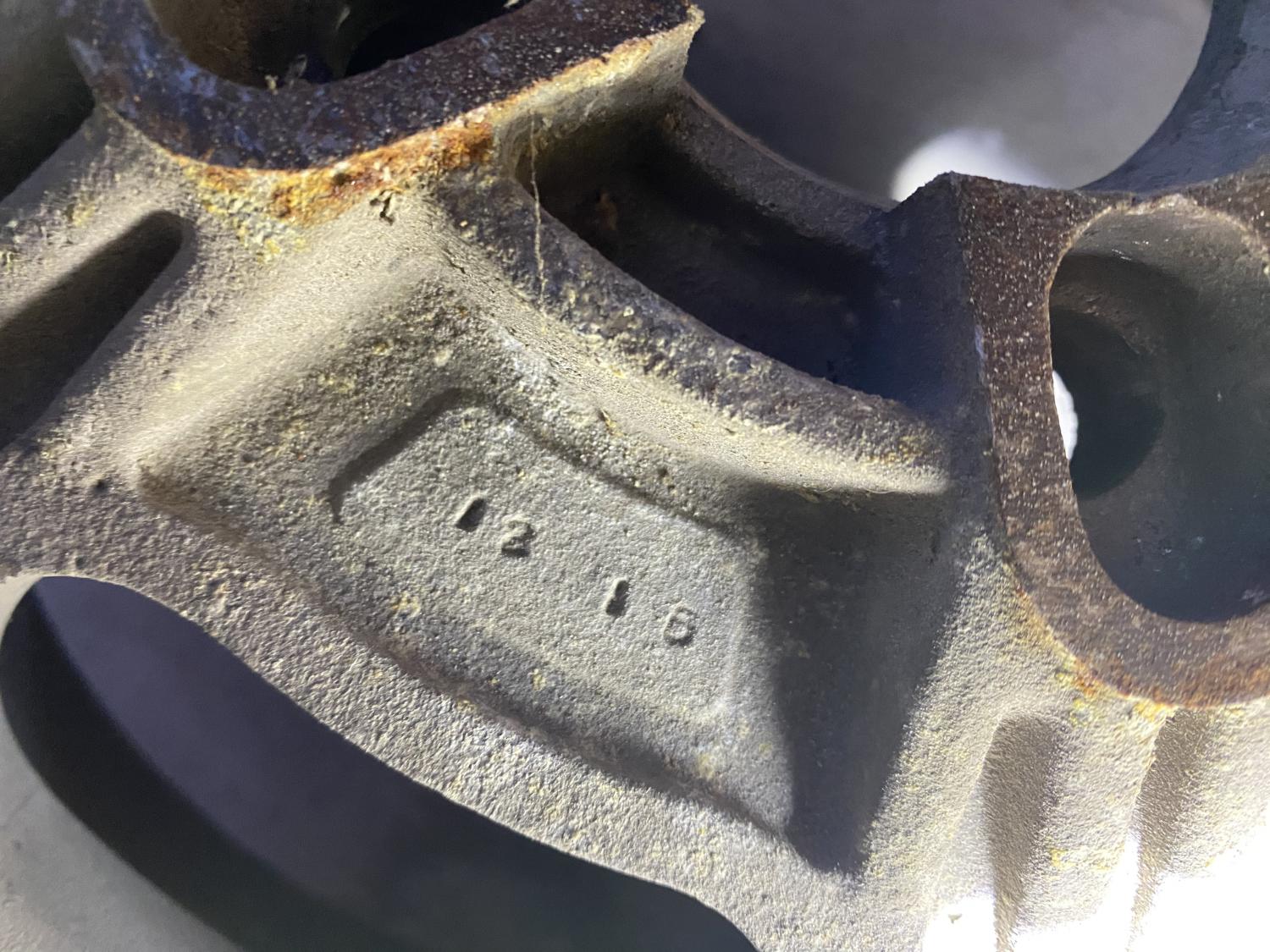

Clearly Ansen Sprint mags.
Is that a date code?

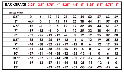

I have not verified that this chart is correct. I have no reason to believe it is not; just have not verified.
Tuna Joe (04-14-2023)
