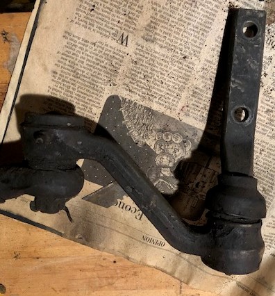

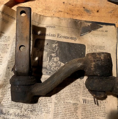

So I actually have 3 aftermarket idlers one stamped 5121-M which is more rounded and two that are cast 14-274 which are more square like the original.
Pics are: Original, Moog replacement, 5121-M, then 14-274
