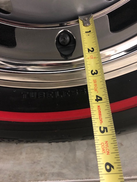

Really good evidence for U shape during the period in question on DG's for Camaro.

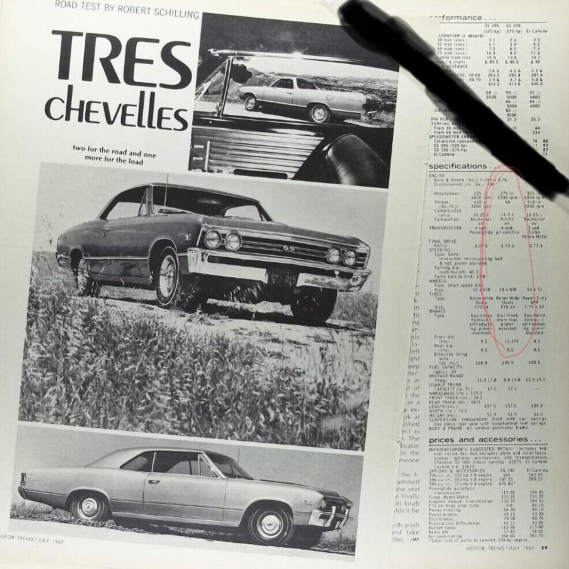

This 375hp car featured in the July ‘67 Motor Trend has factory disc brakes & rally wheels. Those look like the shallower U shaped cutouts to my eye, but its hard to tell for sure. Looks like some gap between the edge of the ring and the inside face of the wheel.

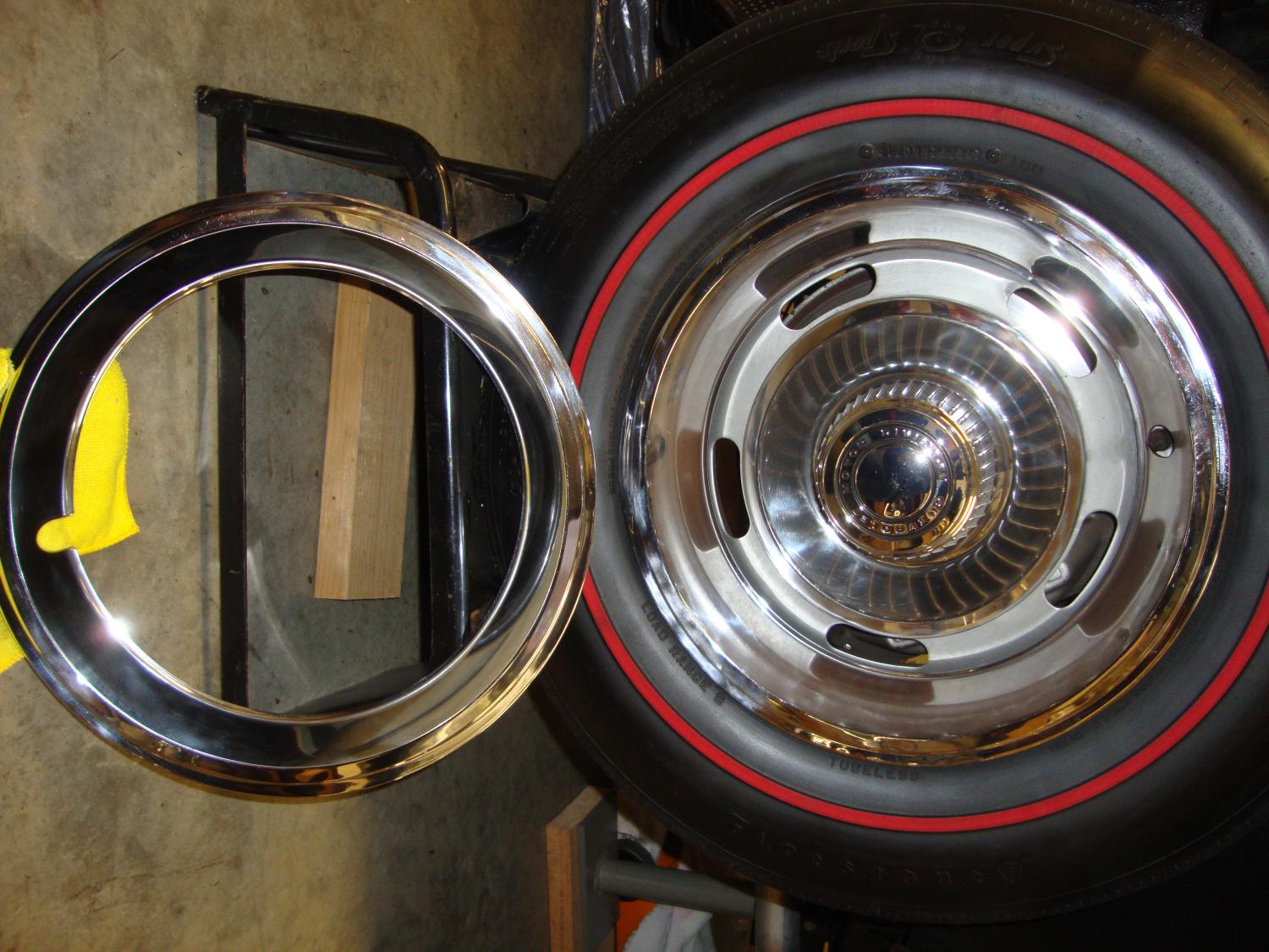

I have run a hodgepodge of rings. Finally Pulled what I believe are the correct 14x6 versions in my attic.
If 67/68 are similar ?? Not sure.
I have ran a set of 14x7 (1969) four clip rings on the red 68 for years and am transitioning to the slotted shallower rings vs- 1969 ellipse deeper rings.

'67 DG wheels on a Chevelle used the 2 1/2" oval hole 4 clip ring whereas Camaro used a slotted ring.
