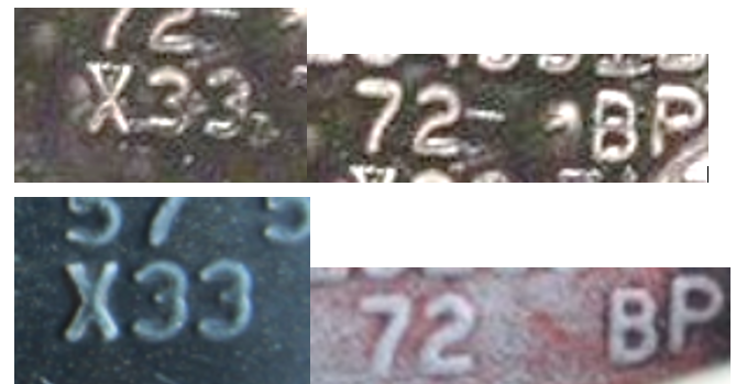

The '69 Z combo everyone wants...orange on white with RS.
What say you about this trim tag?
Link to 1969 Z/28 eBay auction
124379N588597

Shouldnt a janurary car have a 7000 tach?

Black Vinyl top is gone which means it had black stripes from the factory...Joe

You be the judge.
Yes.

----Not any mention of the 4-wheel discs?....Bill S
Retrofitted. Not a real JL8 setup.

Thats a reproduction cowl tag by the way.
----Thans! Kind of figured that. Just couldn't figure out why that dealer wouldn't use that as bait!
