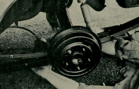

Originally Posted by William View Post
I'm sure they didn't intend to paint the studs but occasionally got carried away.
As I noted in the other thread, the wheel studs had some sort of sleeve (I assume cardboard or tubing) slid over them before the paint was applied, so the threads did not get painted. On low mile survivor 65-67 Chevelles you can see a donut of bare metal on the drum face around each stud, that shows where the outer diameter of the sleeve was. You can also see paint on the very end of the studs, so the sleeve was open on the outer end.
The studs were plated with a black finish to begin with, explaining why the threads also appears black in that pic.
Also note that hex shaped bare spot around one of the studs in that pic. Suggests that at that time frame (is that a 68 in the pic?) one nut was run on one stud to hold the drum on during shipping and until final assembly of the car.

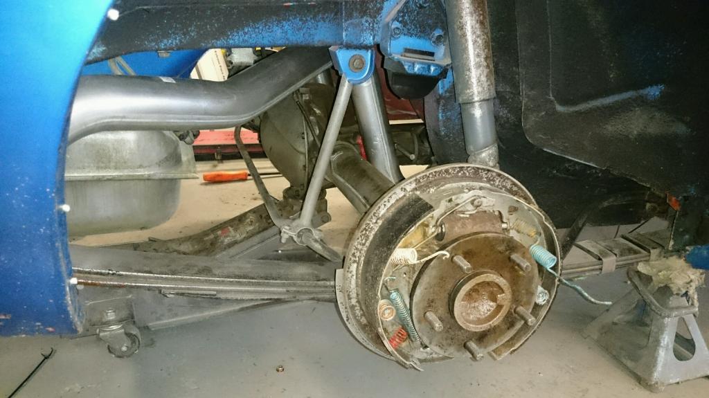

Just putting this here for the record. This is my low-mile 1970 Trans Am after evapo-rust bath. There was nary a hint of black paint on the axle anywhere. dark cast center section, bare tubes.

Great Pic Tracker1. This is pretty much what i have seen on my survivor 70 TA. Very Very Light surface (almost impossible to describe as) Rust. You ca brush it off. Easy to see it was Bare Metal as well.
Thanks for posting....Look at all that over spray.

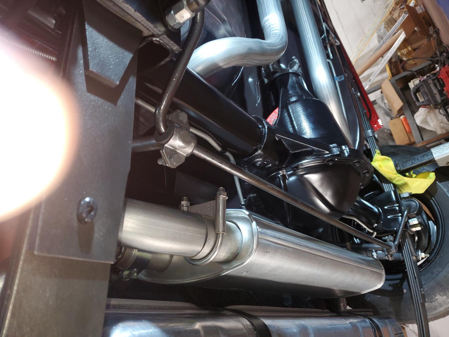

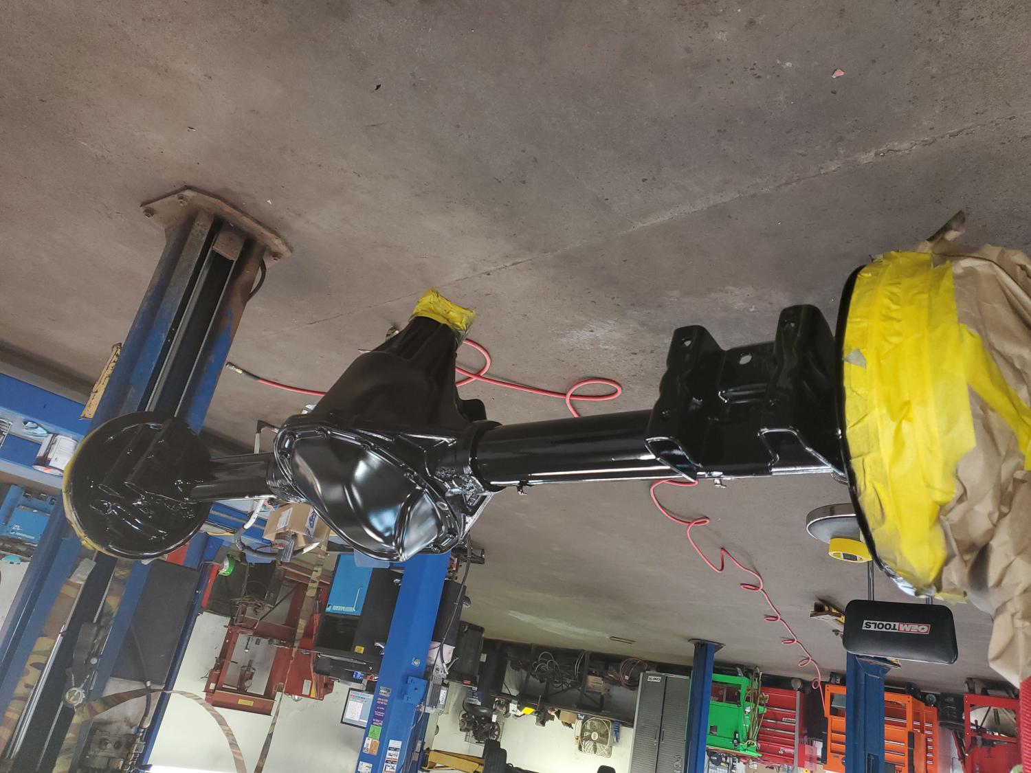

Hopefully this helps. This is how I restored my 70 L78 camaro rear 12 bolt. Pretty much painted everything with the drums on it semi gloss black. The paint used on the rear axles wasn't very good and didn't hold up well.
