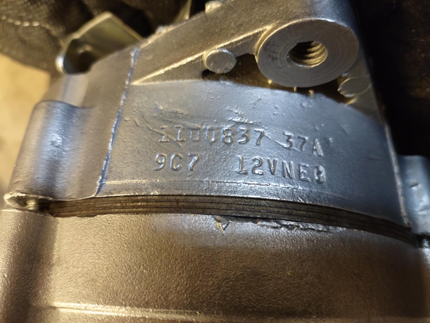

Not sure if this is the correct forum. Please move if need be. I was hoping the experts here could take a look at this 837 Alternator stamp to see if they have any concerns. I'm thinking of putting it up for sale but don't want to misrepresent it. Please and thank you!

It is a good match to a different, unrestored 9C7 837.

Same date as my 05A Z/28
