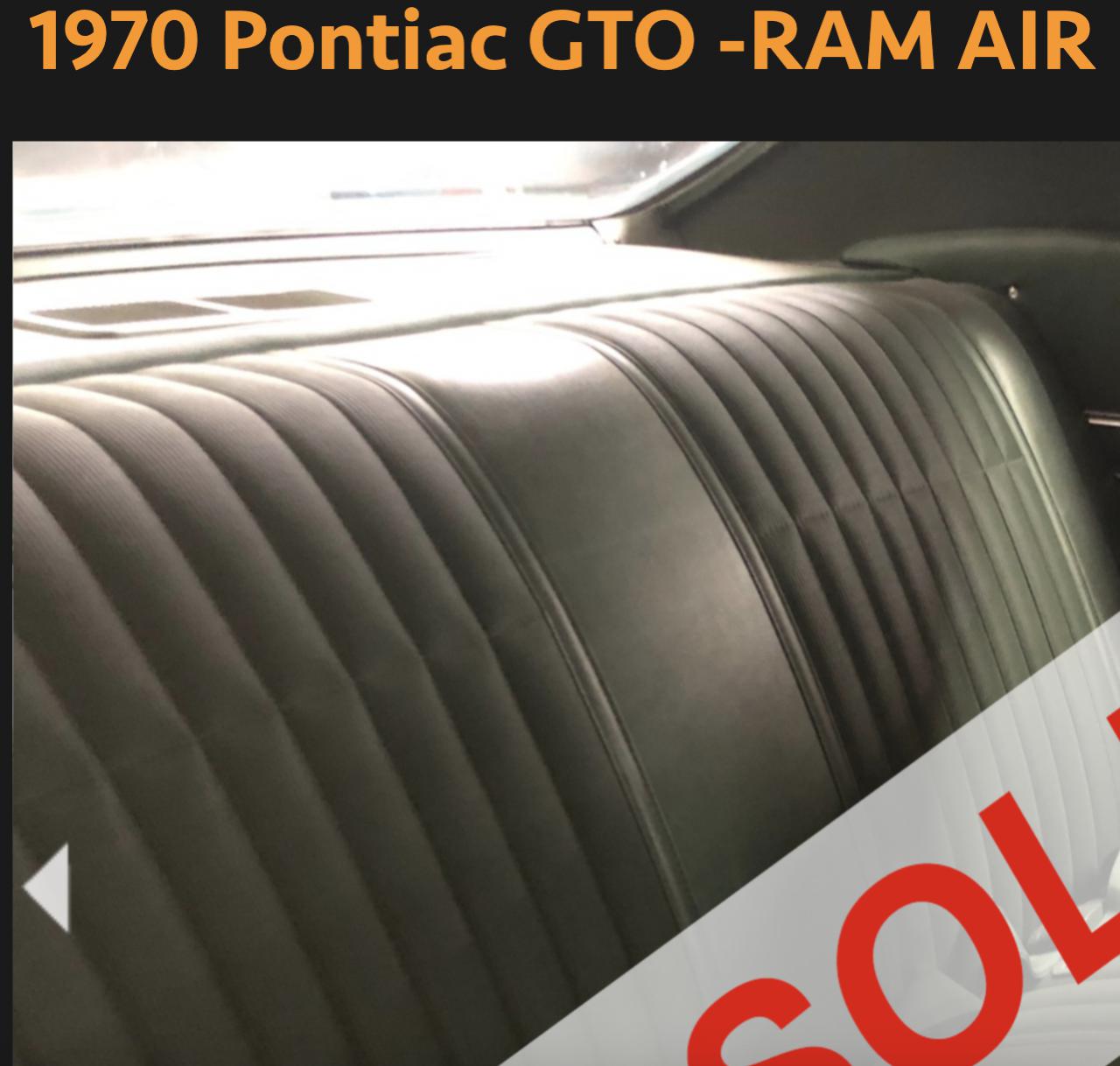

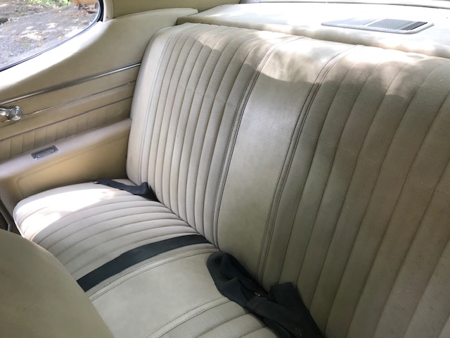

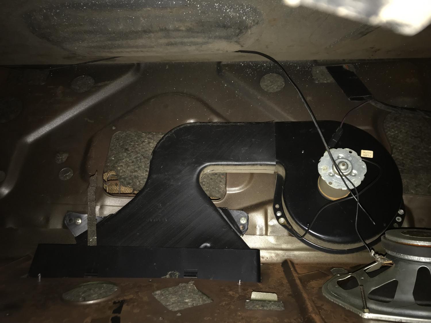

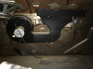

Hoping some can help with a few questions. It appears in several Pontiac Parts Books that there may have been 2 different style Rear Defogger setups used in this model year.
It looks like there is the system that bolts to the rear seat divider with the plastic 90 deg duct and the long rectangular grill right behind the seat
OR
there may be the more common style style that mounts under the package tray with the rectangular grill mounted in center?? grill with NO cut of corner??
WHAT DO YOU HAVE OUT THERE and what is the build date of your car...
Was this a change from early to late?
To add to the questions, my car has an 8 track which automatically gave it the single rear speaker...If you had rear Defog with the package tray mount does this put the speaker off to the passenger side?
If the car had the Seat Divider mounted Motor does the speaker go back in the center?
I know this is a lengthy question but i know there are some knowledgable 70 people out there so i am hoping to get some good info.

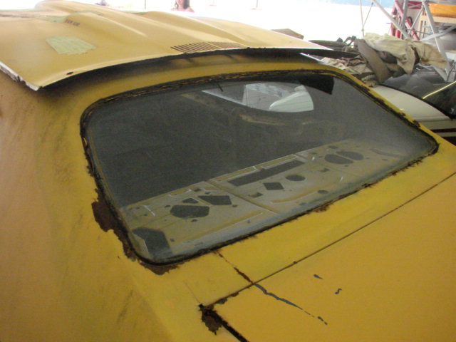

This was my 09/69 built 1970 Judge
See vent in package tray

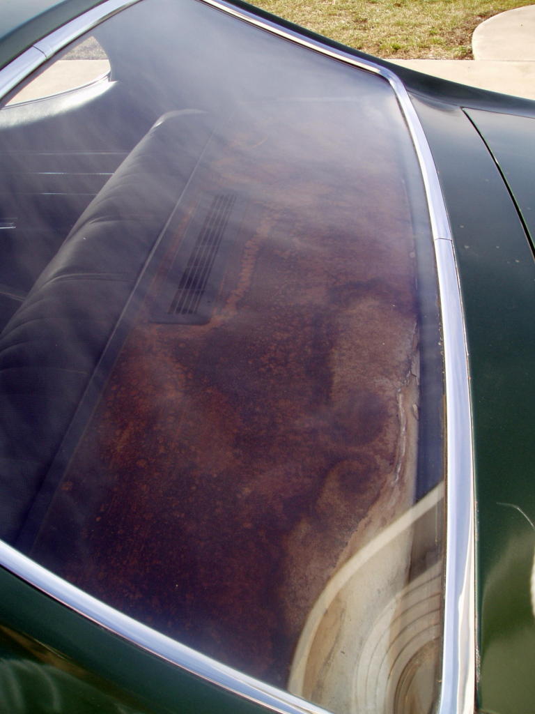

11D '69 built 1970 Judge. Small rectangular de-fog.

So we know that 1969 Used the Seat Divider Mounted Motor with Duct and small rectangle Vent...
The 09/69 built example posted above used that style..
The 11D built example had switched over to the Package Tray Mount
The 05/70 car does not show the system but has the rectangle opening...I think that was there on all cars...Same Package Tray..
Would it just be an early / late transition?
And again if you had the single rear speaker it would go on the Passenger Side Regardless?
Hope we get a few more examples to Narrow this down...
Good Stuff...This is helping...I and the previous owner of my 10D built Judge felt it originally had the early 69 style...Though it was missing...

12c '69

Great Post and Pic Tracker1...Indicates that a 12c built 70 DOES have the package tray mounted motor...
MR70...I did not know Chevelles used BOTH in 1969..I would say it shouldbe relevant but would have to have confirmation that there is a 1969 Lemans GTO out there with the package tray mounted motor... I know 1968 used the PKG TRAY mounted motor so....what does that mean? I HAVE NO IDEA....Still confused but am leaning towards using a Seat Back Motor and Single Speaker on Pass Side...Also helps that I have a perfect unrestored system that came out of a 69....
