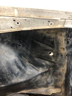

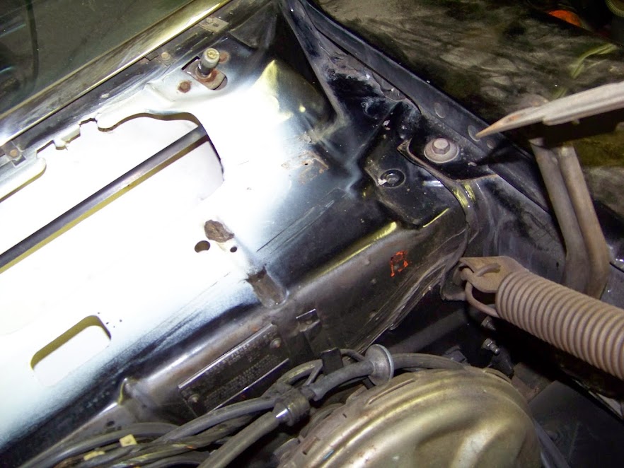

Anyone have a suggestion on what cleaner to use to remove black spray bomb paint from a firewall? Don’t want to disturb factory markings. Thanks

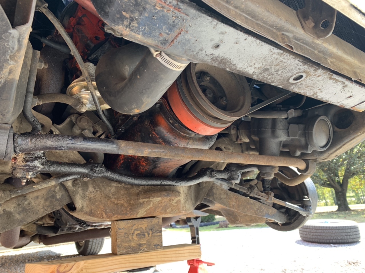

i used simple green on my deuce to do all the firewall/ complete front suspension/ complete front frame and it work great for me...removed spray paint overspray along with grease and dirt
generously sprayed it on and let it sit for 15-20 minutes use a soft brush and then wiped off throughly

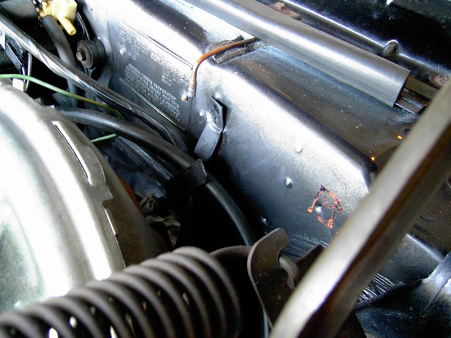

Here is before and after. Before had been scrubbed with full strength Simple green and Purple Power.
