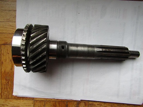

I have a 64 input shaft with 24 teeth with no rings (wide ratio) , the tag that was removed from same tranny that reads 3841435 if i remember correctly was a 3.36 rear ratio. Maybe some one can confirm .

The 3780 beginning part number does not make sense for a 64 or 65 Muncie trans. 3780 correlates to part numbers originally issued in about 1960 or 1961. Numbers of course can continue to be used for years, but since Muncie's did not first exist until 1963 that would not be the case here. For example, the part number listed in the AIM for a 1964 Chevelle Muncie (wide ratio) is 3841435.
So the tag probably does not go with that trans.
You can at least narrow down the maincase to being original to either a 64 or a 65 trans. 64 maincases have a smaller rounded casting boss on the top rear center of the case (where it is drilled and tapped for the hole for the top center tail housing bolt). 65's have a much larger rectangular boss which looks like 66 and later cases.

Ralph,1 ring on the input shift is close 2.20 ratio. 2 rings is wide 2.56 ratio. No rings is m22 on the Muncie factory input shafts.
Early Muncies don't follow the same rules as later ones do. I also had a wide ratio 2.56 (325 case) with no grooves on the input.
Thanks, do you know when they started using the rings?

Looks like 63 through 65 had no groove on the m20 and 1 groove on the m21. I did not know that.
