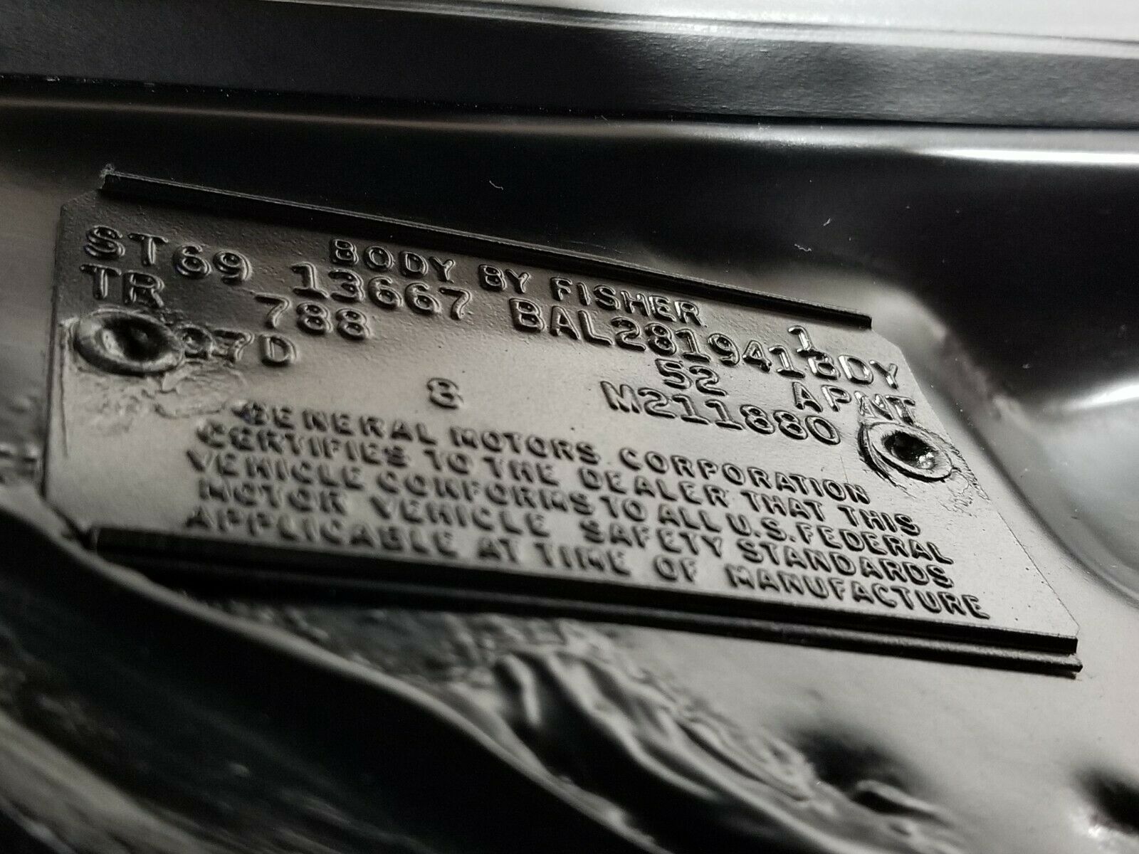

Another beautiful car where the seller is claiming an original block with no pics. Great looking car, but no docs and a replacement Muncie...would sure be helpful to see that engine pad pic. I'll ask the seller if he can provide one.
Link to 1969 Chevelle L78 Convertible auction
136679B408043

The trim tag is missing the L code, and the tag also looks way too crisp to me.

Good call on the L code...personally I believe it's an original tag as it has the right Baltimore anomalies, but I'd also expect to see the L on a Super Sport car.

I thought the L was only on Leeds cars?

The L code was used on Kansas City Mo. Leeds Assembly plant tags,not Baltimore,as this one has.

Yep, that’s what I get for posting too late at night.

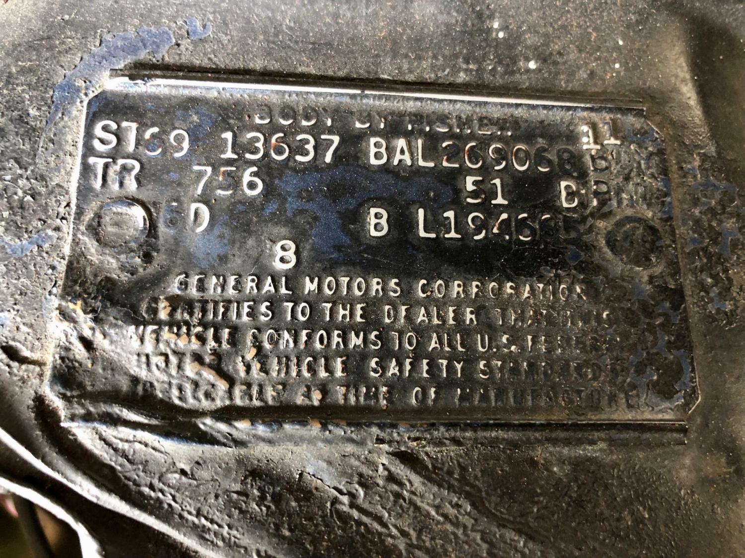

1969 Chevelle Baltimore tags also had the L code for SS equipped cars. 1969 only.

Man, I thought so too. So, the BM would become BL, correct?

Exactly
