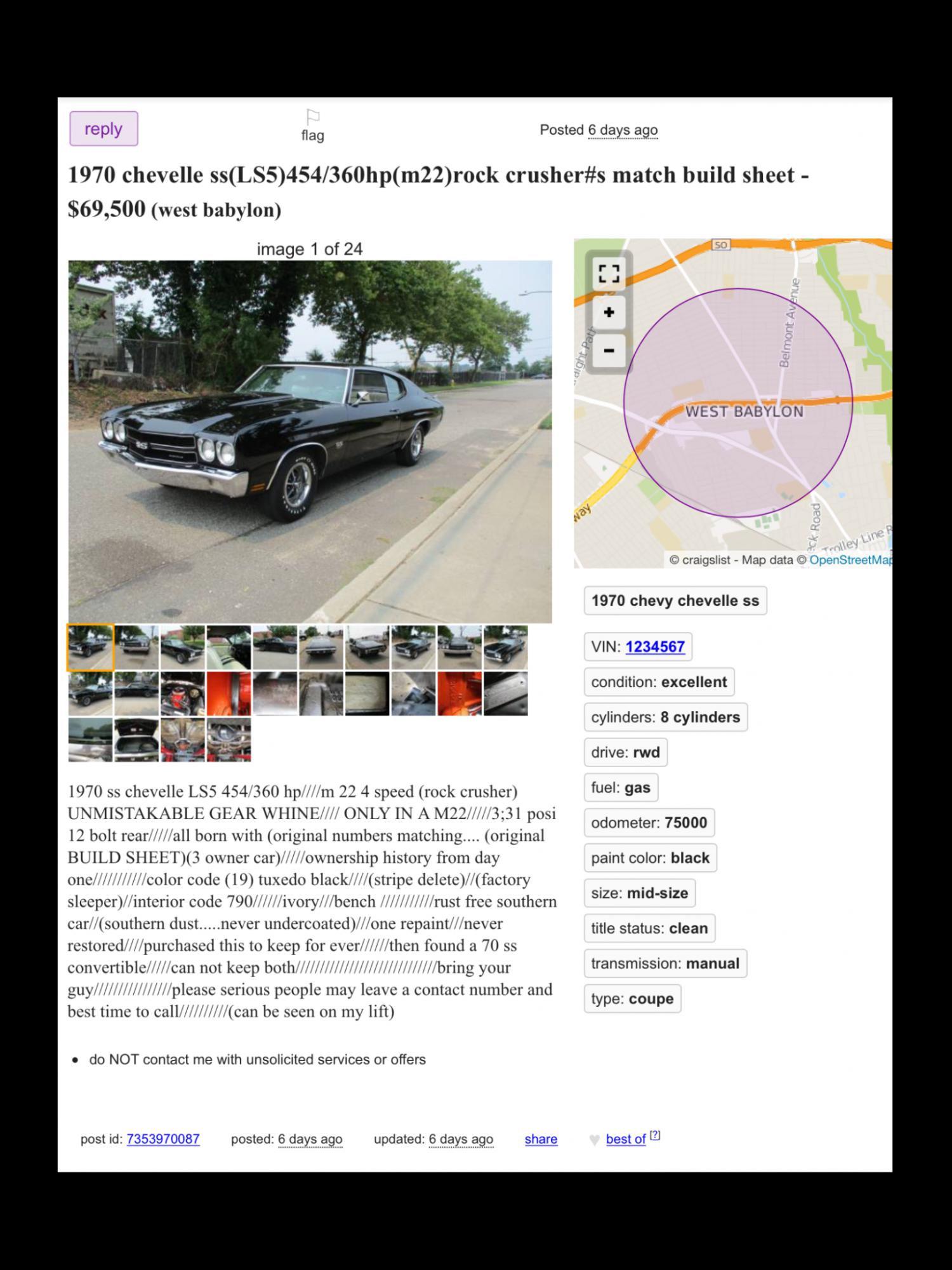

Just saw this on Craigslist.
Quite interesting engine stamp.
https://longisland.craigslist.org/ct...353970087.html

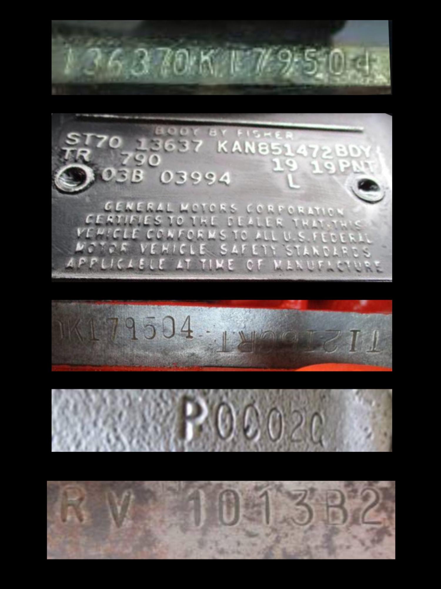

----Good looking 70, but lots wrong under the hood. Start with the stamp pad as the biggest problem, then look at other stuff like the master cylinder, and on and on. I think the car could be a great enjoyable car from what we all see, but you would have to check it out!.....Bill S

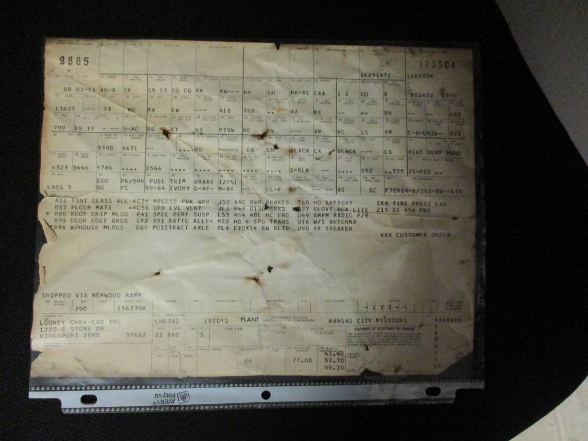

Nice Black w/ Ivory Bench combo, too bad about the wrongs also note trans weld repairs.
VIN 136370K179504
~ Pete

What's wrong with the stamp pad ?

Looks like a typical Kansas stamping to me.

I was thinking the same thing but bit my tongue. The pad looks good to me and the vin looks to match the trans nicely too from what I can see.

I'm no expert, but see something in the vin I've seen before that was not good. Paging Rick Nelson...
