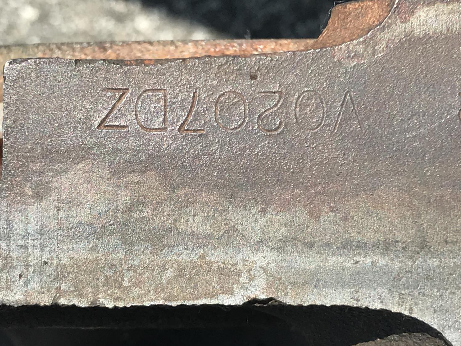

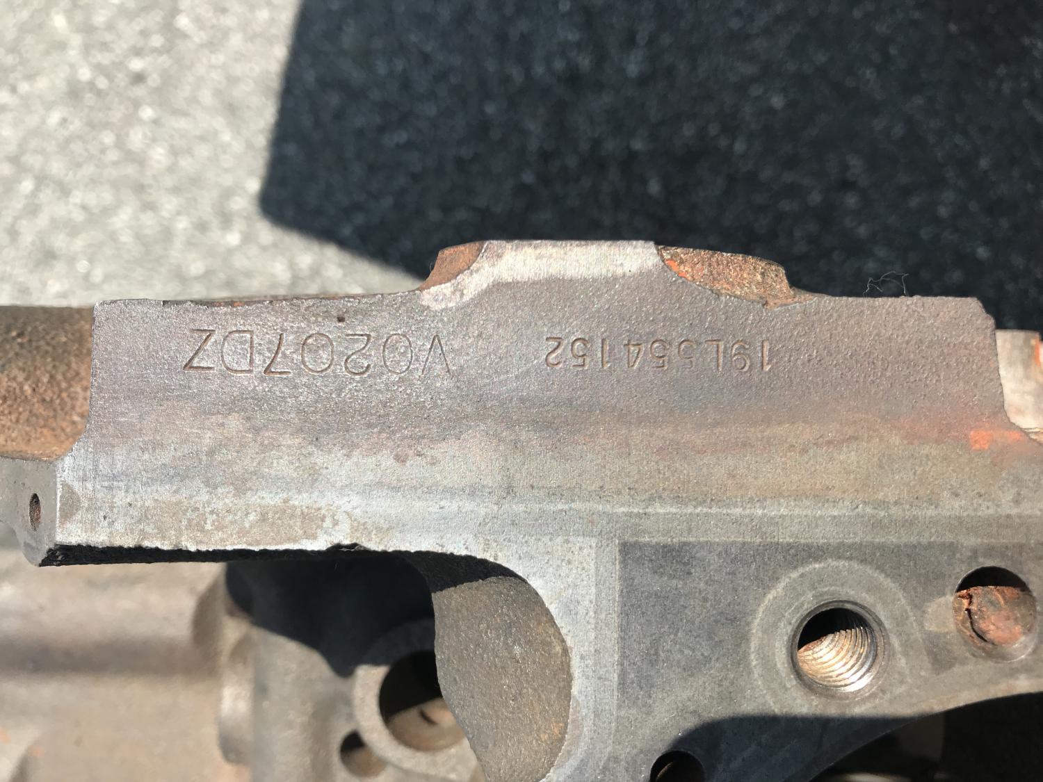

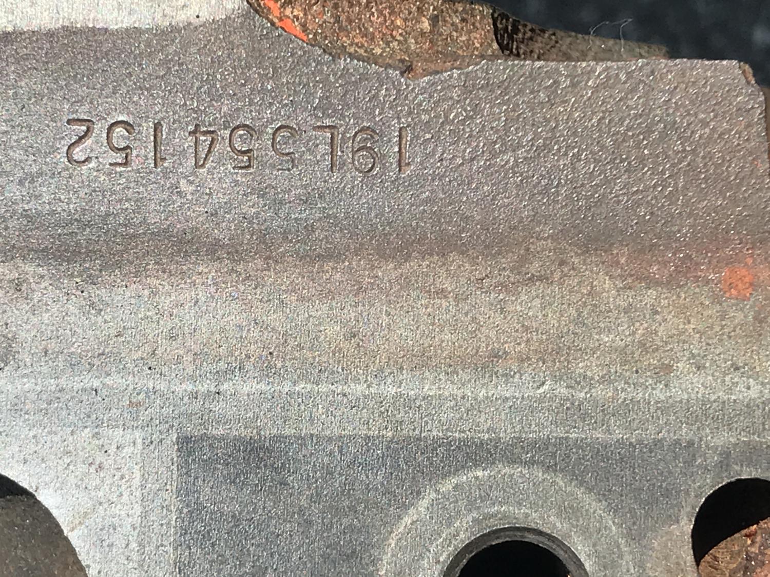

Hi Gang,
Listing this here for the owner of the car first.
I will list for sale with a proper sales ad after I take some more photos / don't hear from the owner of VIN 124379L554152
Would like to see them reunited first. I've also cross posted in the Orphans Thread here.
3956618 casting - cast date of February 3 1969 stamped V0207DZ
Standard bore still!
Cheers all,
Anthony
Attachments - The Supercar Registry IMG_2698.jpg IMG_2697.jpg IMG_2696.jpg full-4703-57033-full_4703_35111_007.jpg

Going to be tough to match this block up. LOS VINs only went as high as 9L531163.
A February stamped block would have a VIN 9L52XXXX.
Maybe just the second digit in the VIN is messed up.
- Warren

a mirror image 5 might look like a 2 in a gang stamp holder after hitting 65 of them in an eight hour shift... could the second "5" be in place of a correct "2"?
either way... let's hear theories and or comments on the pad / stamping before I abandon this.

That's one of two known block VIN stamp anomalies at Van Nuys February/March 69. VIN on the chassis would have been 124379L524152.
Not in the db, does not come up on a Google search.

I know of five other blocks with that misstamp.

Interesting, thanks Kurt, as in, they are "554" when they should've been "524"?
Makes sense, as I assume it wouldn't have been noticed right away, even though it 'should've been'...
