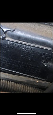

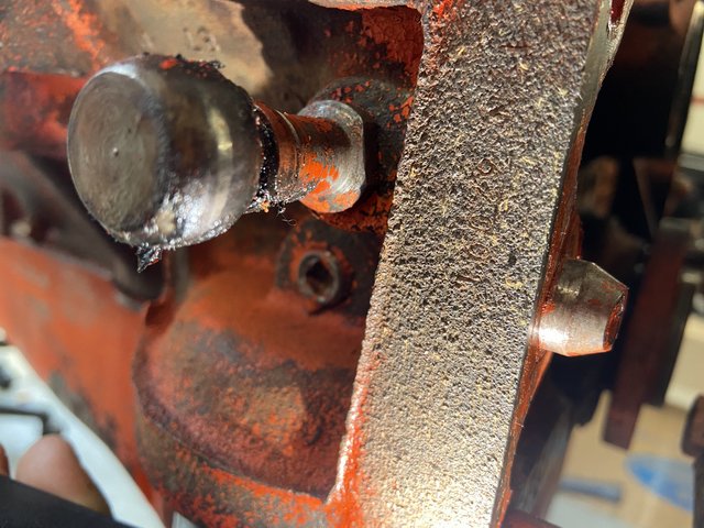

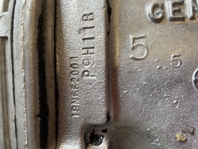

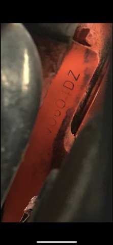

Here you go.

Not great pics of TT and engine stamp but like what I see... Thanks for posting
