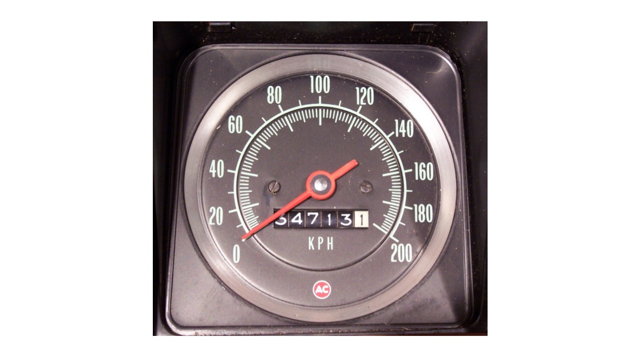

Check out the speedometer. It has kilometers on the inner part of the face inside miles per hour.

PHP Code:
Check out the speedometerIt has kilometers on the inner part of the face inside miles per hour
Could the car have been originally built for the European market?

Inner Kph #'s appear added also flaking off plus a different face layout than original U18 Speedos.
Needs an NCRS report if one not done already also Canada Vintage Services Paperwork may be worth a whirl as when the Metric system hit Canada and Road Signs changed here mid 70's, lots of Speedos were modified w/ Metric #'s added so subject car could've migrated from the North?
