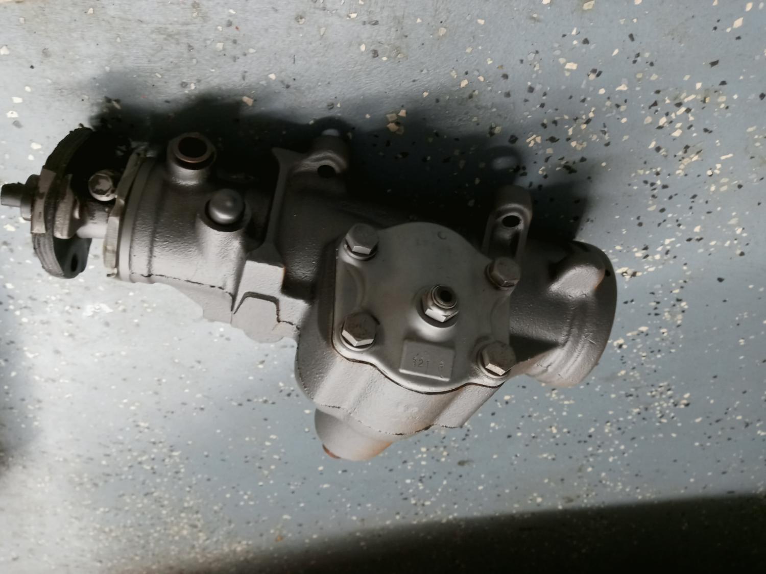

Default Power steering
I have this

Old 12-15-2020, 12:22 AM

Old 12-15-2020, 03:18 AM
jl8z28 jl8z28 is offline
Yenko Premier Member
Join Date: Jun 2003
Location: Maryland
Posts: 1,594
Thanks: 17
Thanked 121 Times in 86 Posts
Can you tell what the year is it could be a 8 or a 0
Old 12-15-2020, 01:51 PM
X77Z28MP X77Z28MP is offline
Join Date: Feb 2012
Location: Hudson Valley NY
Posts: 214
Thanks: 95
Thanked 37 Times in 17 Posts
Looks like a 0 anyone else see a 0
