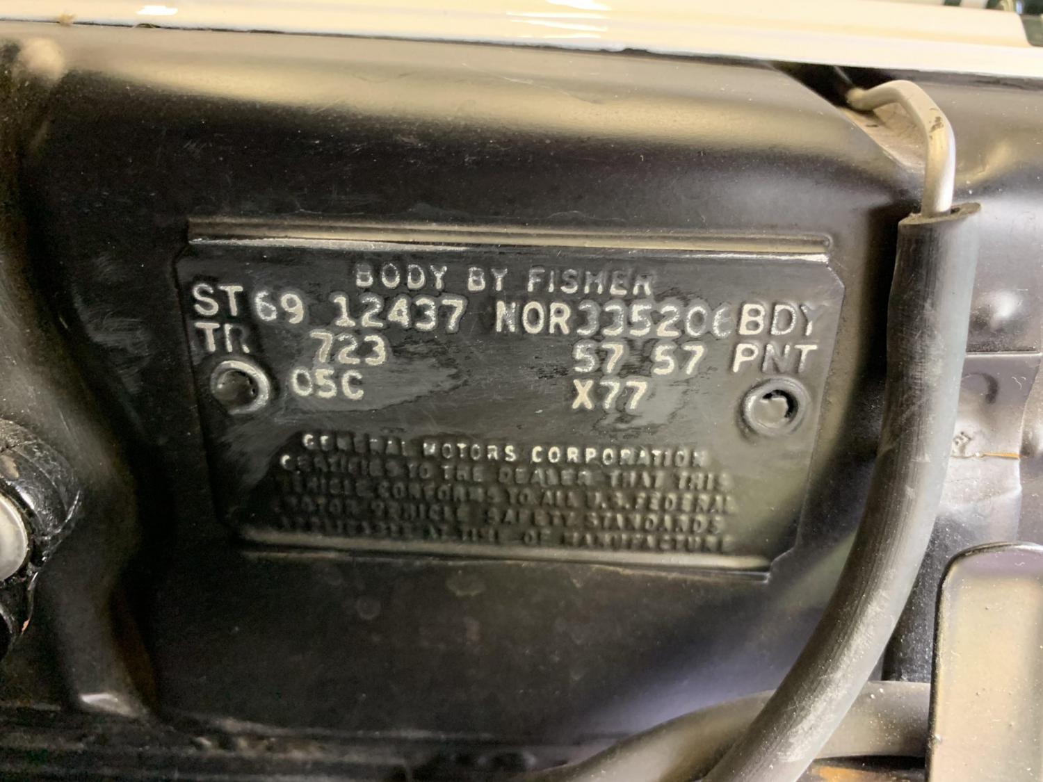

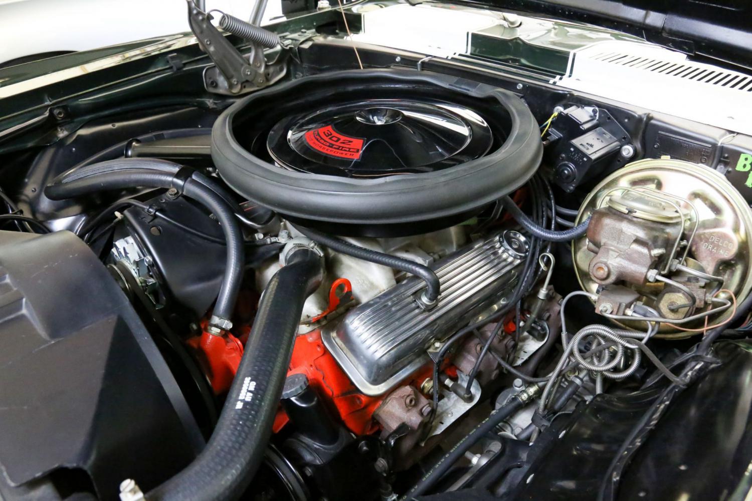

NOM, some black interior components for a green interior, looks like sold in 2010 at Barrett-Jackson Vegas. Cowl seal on backwards, sanded tag, aftermarket Hurst? I do dig the stance, and the Flowmasters sound lovely too. Looks like a fun driver!

What possesses people to sand cowl tags!!
Rant over
cruiserofland (10-21-2020)

It’s the same POSSESSION that comes over them to Sand and Scrape the paint off an engine deck pad. LOL
THE DEVIL!!

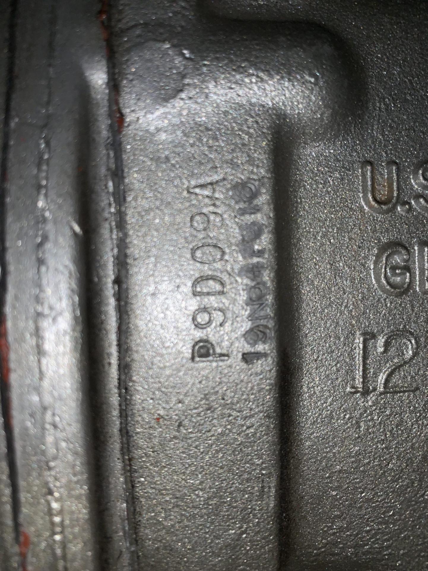

Trans and axle stamps:

At least the cowl tag is real...
Easy way to get the numbers & letters to be read clearly

Doesnt look like any of that drivetrain is original.
VIN stamp on trans is not factory.
Chinese booster.
