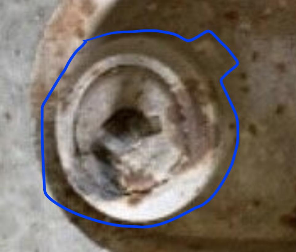

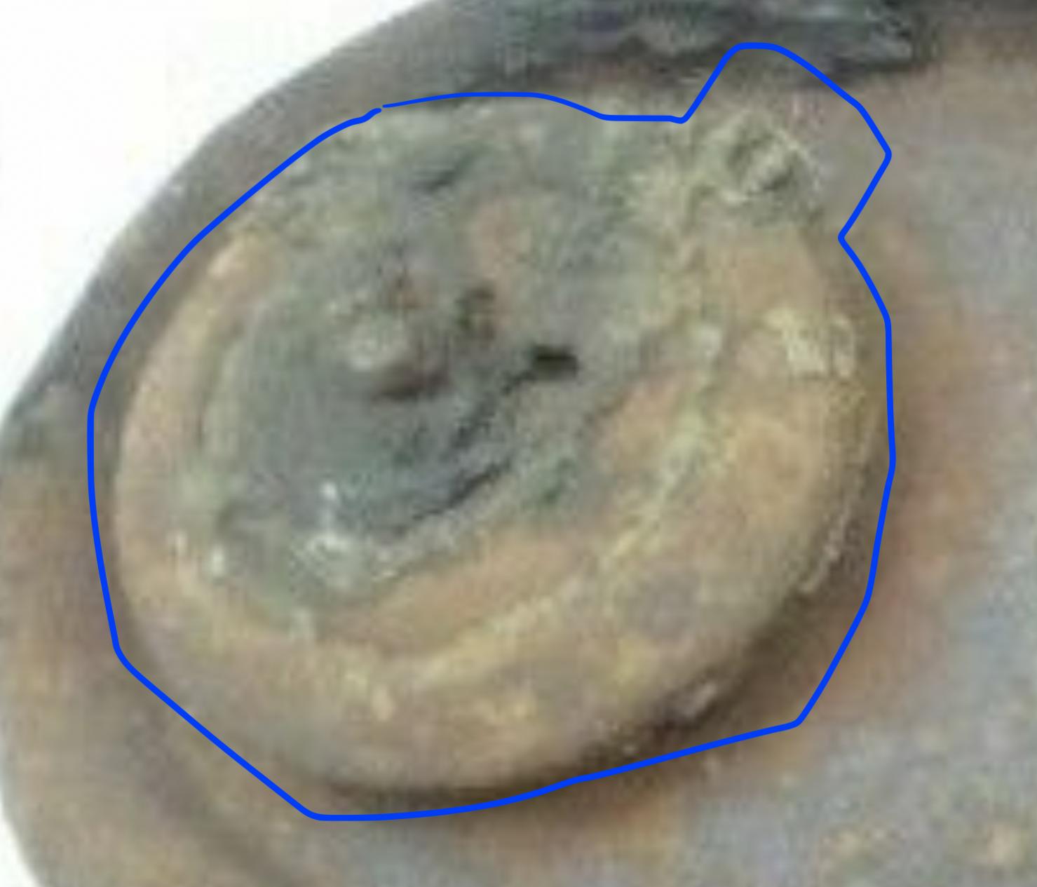

I recently realized that the NOS lower control arms that I had
installed in my 1970 Camaro LCA's were NOT the Correct (with Tab) Style
for a LEGENDS Quality Restoration.
I have other Control Arms with Correct Original Ball Joints that
Im wanting to remove, restore the cosmetics & install in my
Original LCA's
Ive been instructed to pry off the Dust Boot Retaining Ring.
After soaking the Ball Joint End of Arm in Evaporust and using
KROIL I'm not able to budge the Boot Ring and it will easy to
bend and otherwise destroy it.
How can I press directly upon the threaded stud , as wont it
want to move and not stay straight....
I searched a bit, but couldnt find you tube video that dealt with this.
Thanks

What you are proposing could be done; but it won't be easy.
You still run a risk of damaging the boot ring.
Assuming you have a good hydraulic press.
Spin the nut on top of the stud until it is perfectly flush with the top.
You may need to fab a fixture to place the LCA on to get the stud pointing straight up.
The nut will give you a larger flat surface to press down on.
I realize you didn't ask for any opinions, but are you CERTAIN the ball joints don't have any play in them? My recollection on Camaro lower ball joints are the the factory units were seldom good for more than 40k miles, even with regular maintenance. I replaced my originals because they had some play in them and my car only had 24k miles at the time.

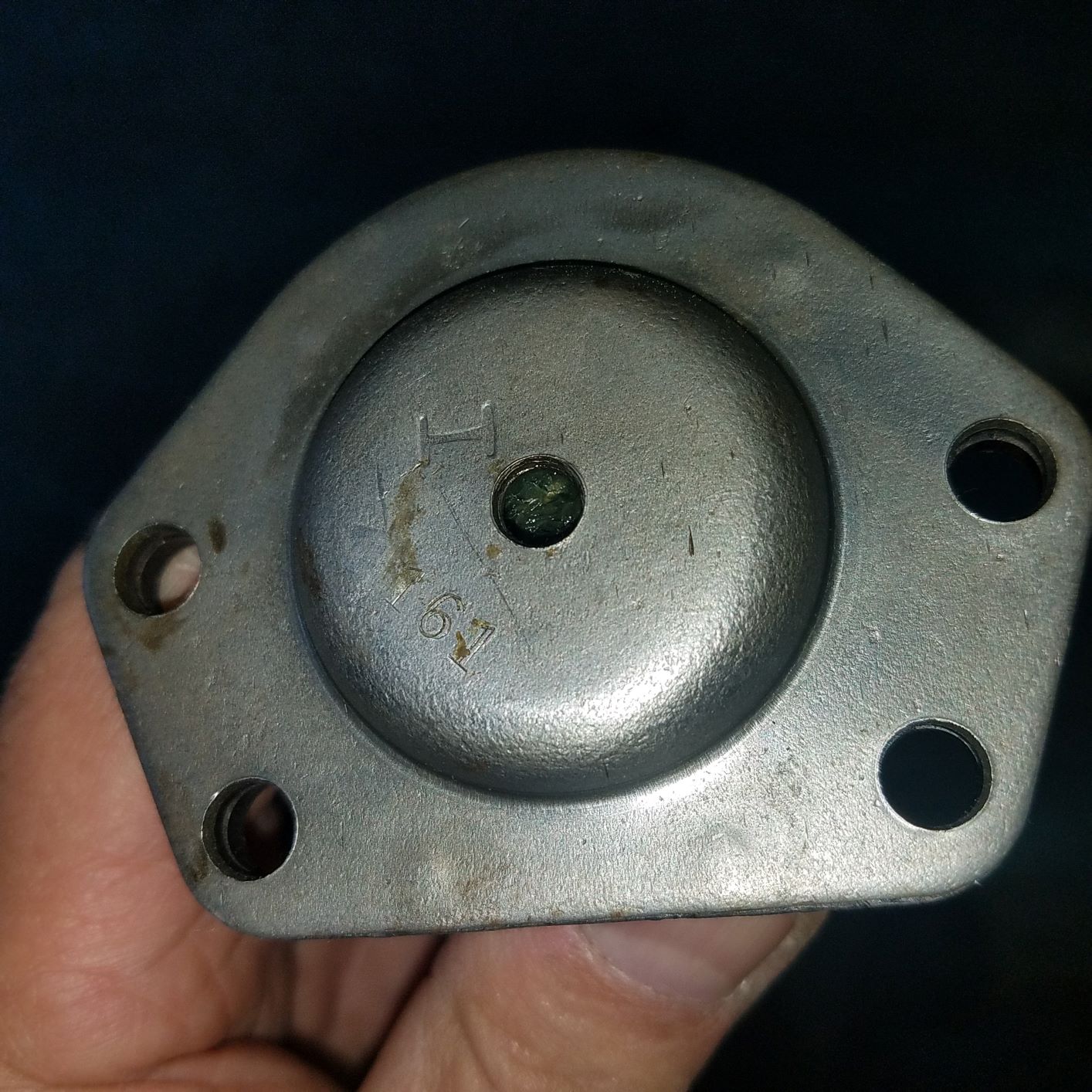

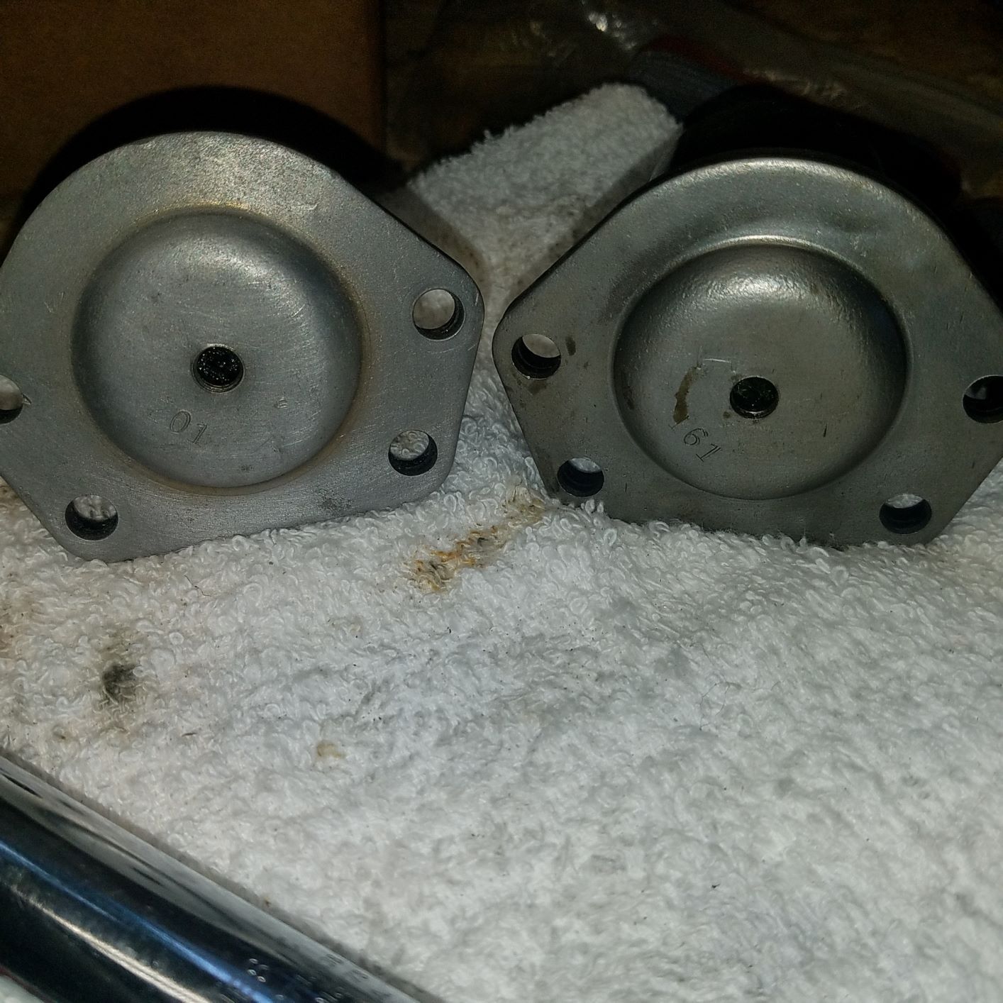

Can someone post pics of the lower ball joint with tab as opposed to the replacement ball joint?
Old 06-02-2020, 03:52 AM
L16pilot L16pilot is offline
Join Date: Mar 2016
Location: Maryland
Posts: 458
Thanks: 568
Thanked 493 Times in 168 Posts
Here is an NOS assembly line correct 70 Camaro lower ball joint with the tab for reference
Steve Nuwer
www.2ndGenZ.com
