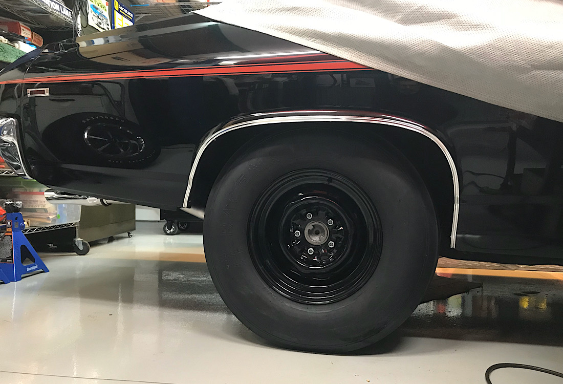

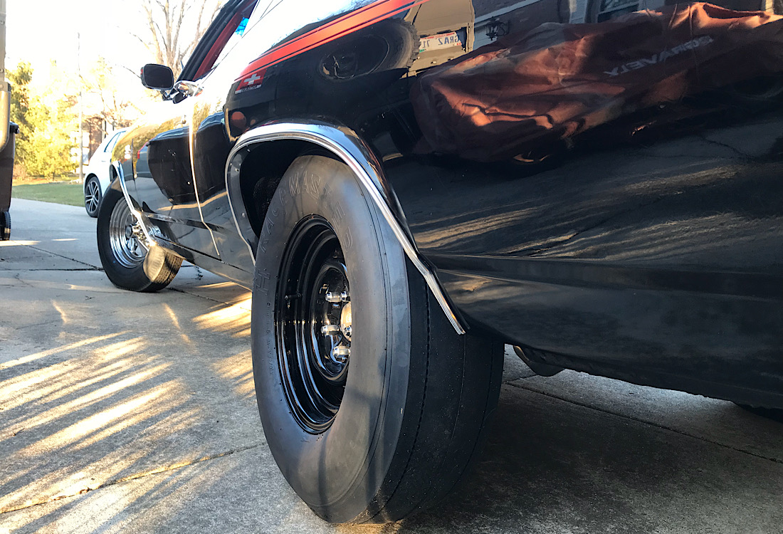

I have the 7” wide versions of these 29 1/4” tall cheater slicks installed on my Chevelle (A body like your GTO) with a ?similar? rear wheel well. They fit height and width wise but aren’t as wide as the 9” versions you are looking at. I do have air shocks but don’t need them for clearance. No tubes required for cruising.
