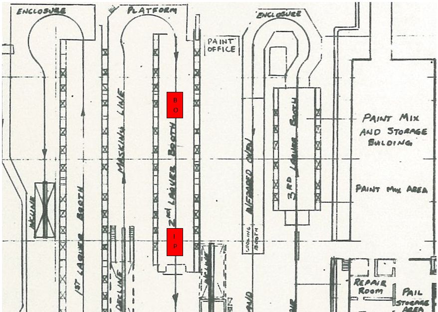

Questions about Norwood's paint sequence for F's unibody in 1970. After body paint, what was the order for the firewall/cowl and dash areas? Was the dash painted first then the blackout or the other way around? And when was the windshield installed during all of this?
Thanks for any help.
