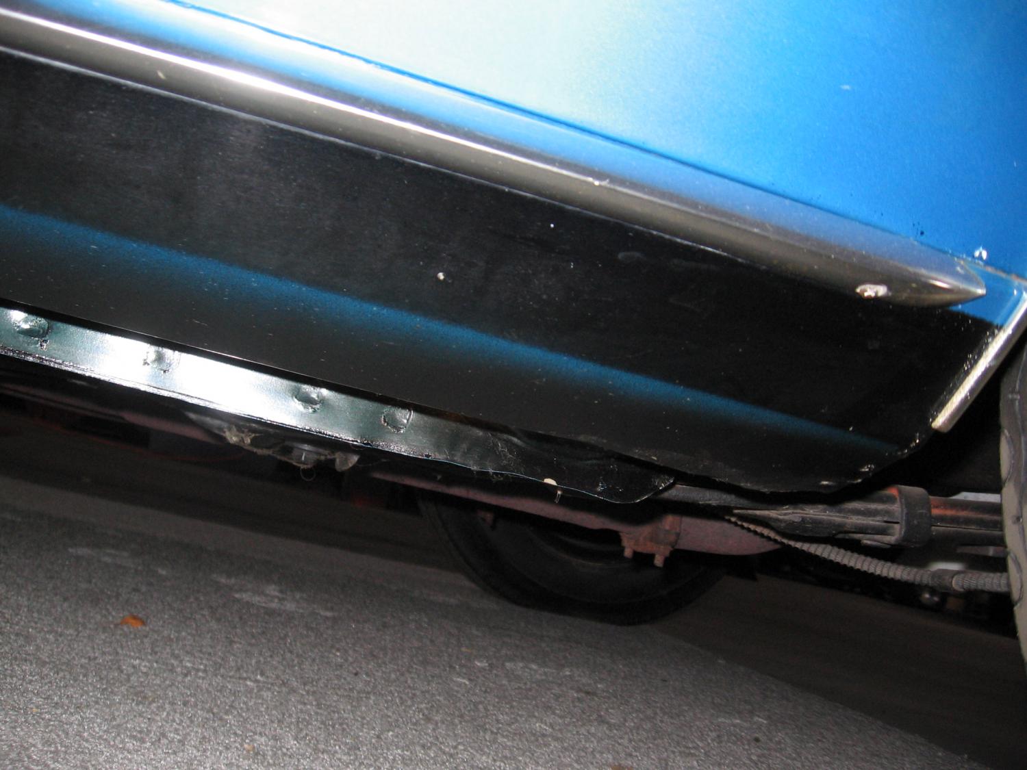

On a 69 camaro was the blacked out rocker paint kept under the trim molding or carryed into the door jam

under the moulding.

I think it terminates at the point of the spear.

Correct. When laying it out use the screw holes for the trim mounting strip as the dividing line for the blackout.

Here's an original paint car for reference blackout position with respect to rocker spear and end point.

Good picture. That's what I was trying to explain to my painter yesterday...Joe

Does the rocker spear angle up or does the paint tape line angle down on the ZL1 drivers fender?
