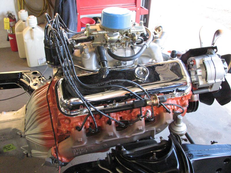

I almost did, but I didn't leave the block bare behind the manifolds. Two step painting. I couldn't bring myself to be THAT correct.

Name:  Eng installed-4.sm.jpg

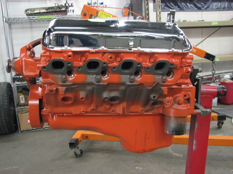

I modified an engine cradle so the bell could be attached during painting as it was done at Tonawanda.
Verne
Name:  Eng Painted-3.sm.JPG

Right, wrong or otherwise, I restore mine the way they were painted originally unless the customer says no. Concours is concours. I do not paint my manifolds entirely but rather I paint them to simulate what they would look like after much of the paint has burned off.

I use an airbrush with the engine paint so I can lightly spray the manifolds and other high heat areas to allow the heat to dissipate through the paint or burn off like appears on original low mile cars... this is prior to firing the engine... and after
one of the masking of the pad...

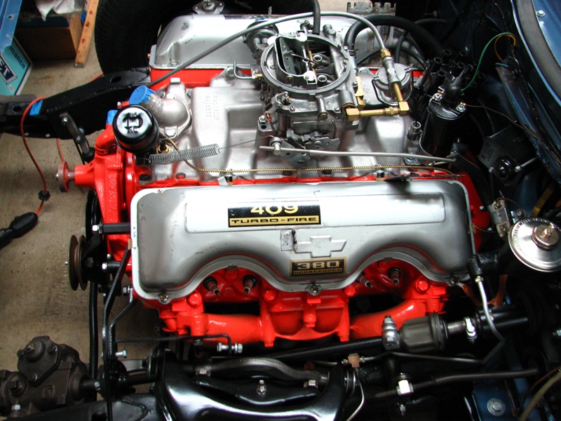

Here's how mine came out. Took the paint out of the can & shot it with a HVLP...Joe

shouldn't the heater hoses be ribbed and not GM stamped?
