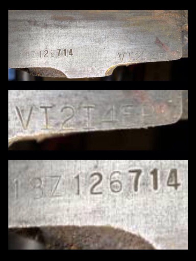

Saw this while on craigslist. Stampings look ok? I don't know the person. Just thought I would post in case somebody needs it or has the car it goes to.

That’s an extremely rare large journal 3.25 stroke crankshaft.

Needs an eyeballs view or better pics as the Z Digit = Fremont Plant so not a Nova and probably a Chevelle/Camino Vin?
More digging necessary too as EP's a '67 suffix not '68 A-Body or if early could be, note Dec engine build?
