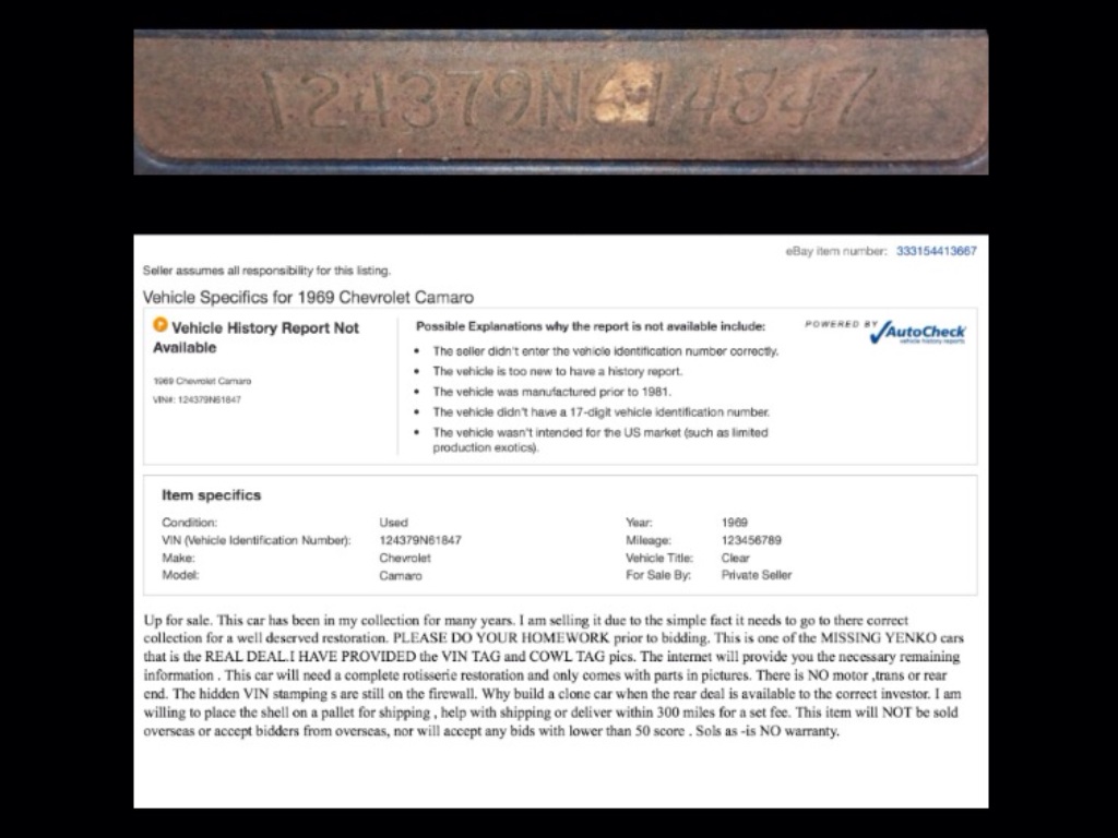

https://www.ebay.com/itm/1969-Chevro...ZcsKd~&vxp=mtr

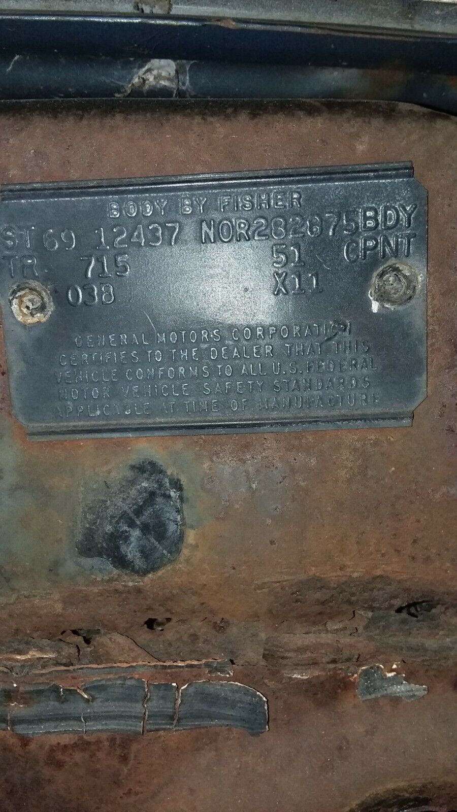

For only $30K, you could own the only dusk blue Yenko! With original tires included!
Kurt S - CRG
Old 04-12-2019, 07:58 PM
WorkinProgress WorkinProgress is offline
Join Date: May 2012
Location: Constitution State
Posts: 506
Thanks: 38
Thanked 193 Times in 104 Posts
Wonder why he took a picture of the 4 piston calipers next to the console? Hopefully the 140 speedo can be salvaged, not sure about the rest of the body.
- Warren
Old 04-12-2019, 08:12 PM
William William is offline
Join Date: Jun 2001
Location: New Berlin WI USA
Posts: 2,659
Thanks: 254
Thanked 2,917 Times in 812 Posts
No one noticed the standard production heater?
Old 04-12-2019, 08:33 PM
Posts: 20,934
Thanked 3,562 Times in 1,440 Posts
And with a Blue vinyl top.
Old 04-12-2019, 09:14 PM
Join Date: May 2012
Posts: 506
Thanks: 38
Same could be said with no ducted hood wiring hole above fuse box, and wrong throttle lever.
- Warren
Old 04-12-2019, 09:31 PM
PeteLeathersac's Avatar
Join Date: Jul 2005
Location: O’ Canada
Posts: 12,452
Thanks: 19,051
Thanked 5,903 Times in 2,461 Posts
All considered, best grab an NCRS Report to confirm shipped to Yenko as it could be another incorrect Vin recorded by Yenko?
~ Pete
purple panther (04-13-2019)
Old 04-12-2019, 09:45 PM
bergy's Avatar
bergy bergy is offline
Posts: 2,812
Thanks: 897
Thanked 1,451 Times in 396 Posts
body number is way off.
Old 04-12-2019, 10:10 PM
Join Date: Jul 2005
Location: O’ Canada
Posts: 12,452
Thanks: 19,051

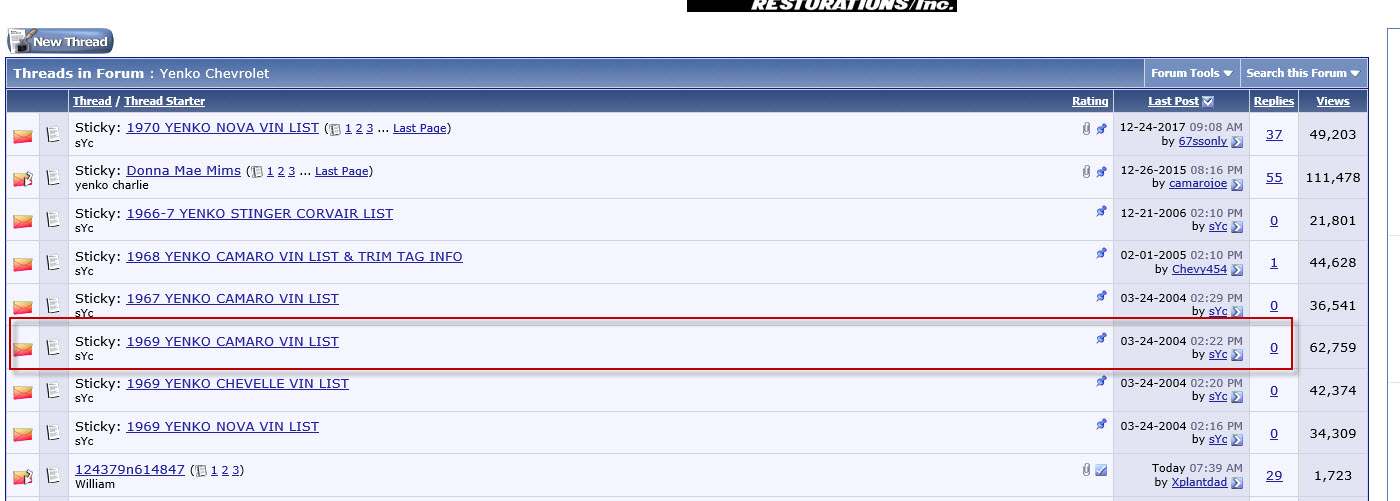

Looks like we've got two threads going on this same car but everyone arriving at the same conclusions.
124379N614847
