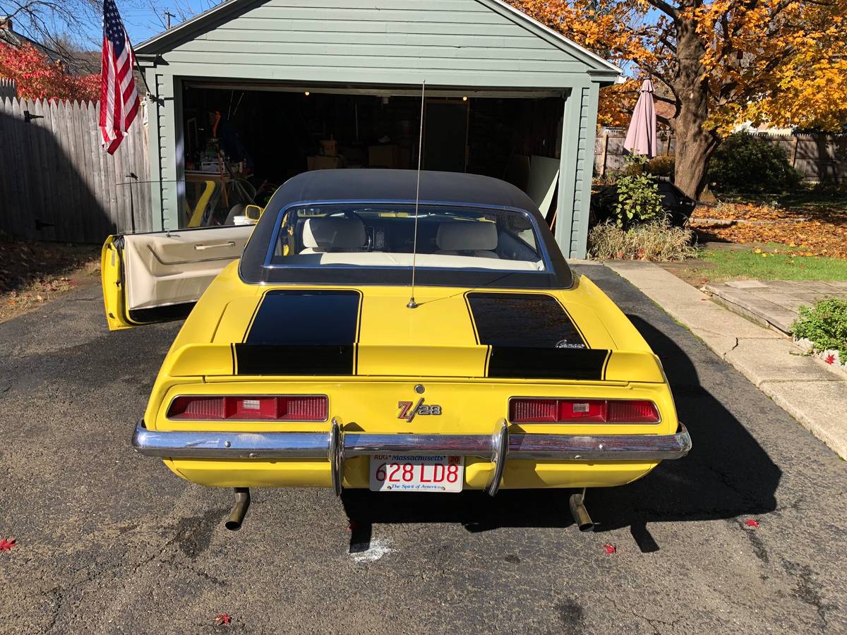

Anyone familiar with this one?
https://sandiego.craigslist.org/csd/...782971384.html

I do not know the car. Not many photos.
If that is original paint, it looks well preserved.
124379N620470 looks to be the vin.
If it is rust free, with original paint, and really has only 7980 miles, it is priced under market value.

Dont think GM ever did a hard tape line at the firewall.

Dash looks to have been painted.

I agree with allcamaro, too many tape lines on the top of the cowl

Thats the least of its issues.
