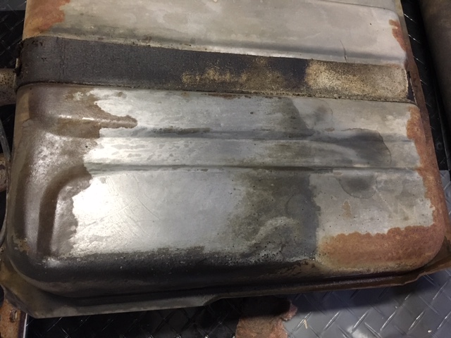

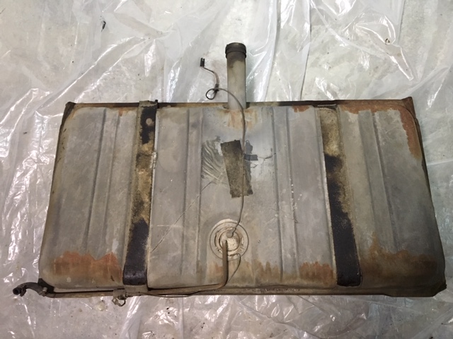

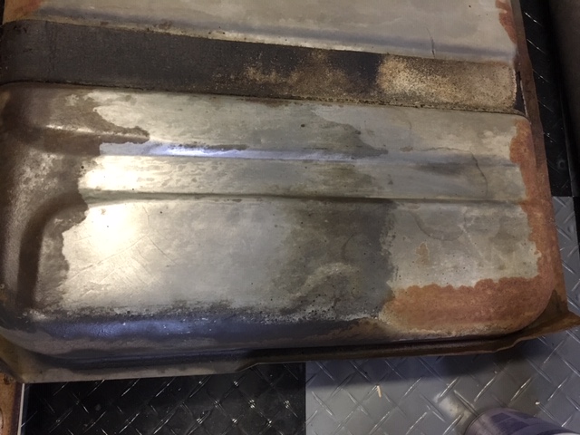

Any tips from those that have been there to cleaning up an original tank without damaging the original galvanized finish? Here's what I got....

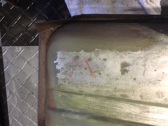

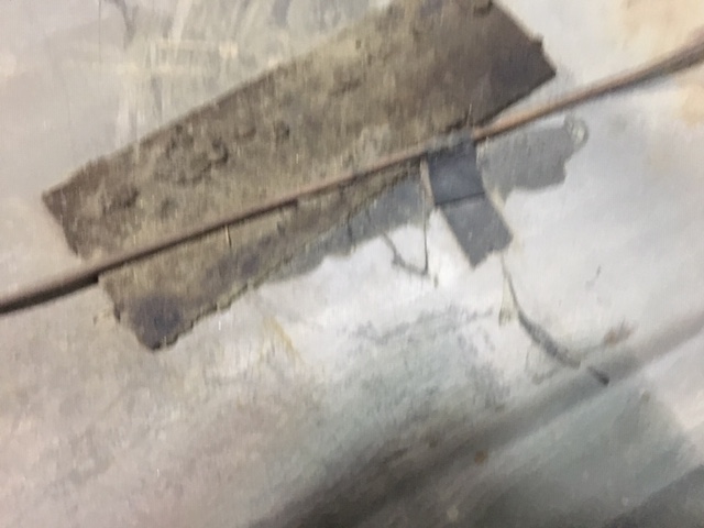

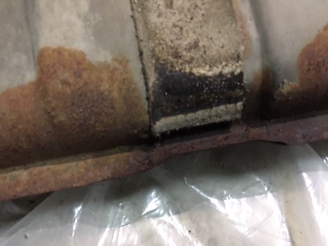

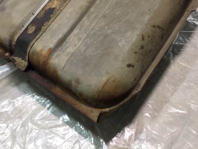

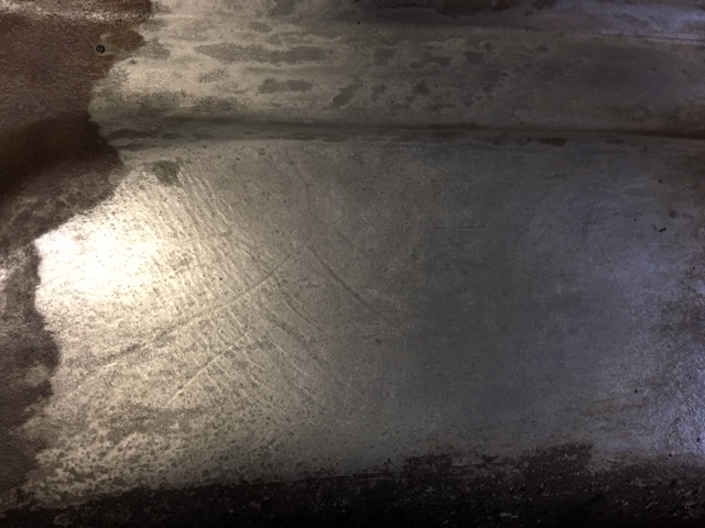

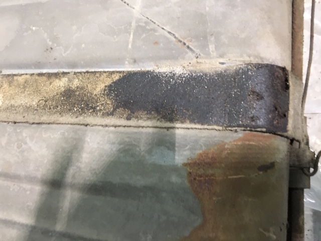

Did a little work on the tank today using the above process.
Photo 1 - "as removed" surface
Photo 2 - cleaned with "purple power" cleaner mix
Photos 3,4,5 - Brasso applied with bronze (fine) wool and wiped clean with a damp cloth.
Long way to go, but it looks doable for saving the original tank finish. I have some evaporust on some of the rusted areas right now, will go back at it tomorrow.

Evaporust did a decent job of removing the rust, am now left with a stain to deal with. The evaporust process revealed a "3" on the rear end/driver side/top of the tank - anyone know what this is for?

That's not a stain....the rust that you removed had eaten away the factory "coating" (tern finish). It's pretty much bare steel in those areas once the rust is removed. Likely, anywhere you have that surface rust you are going to see the same thing if you remove it. It would take some sort of creative "painting" to make those areas look like the better, still coated, adjacent areas.
