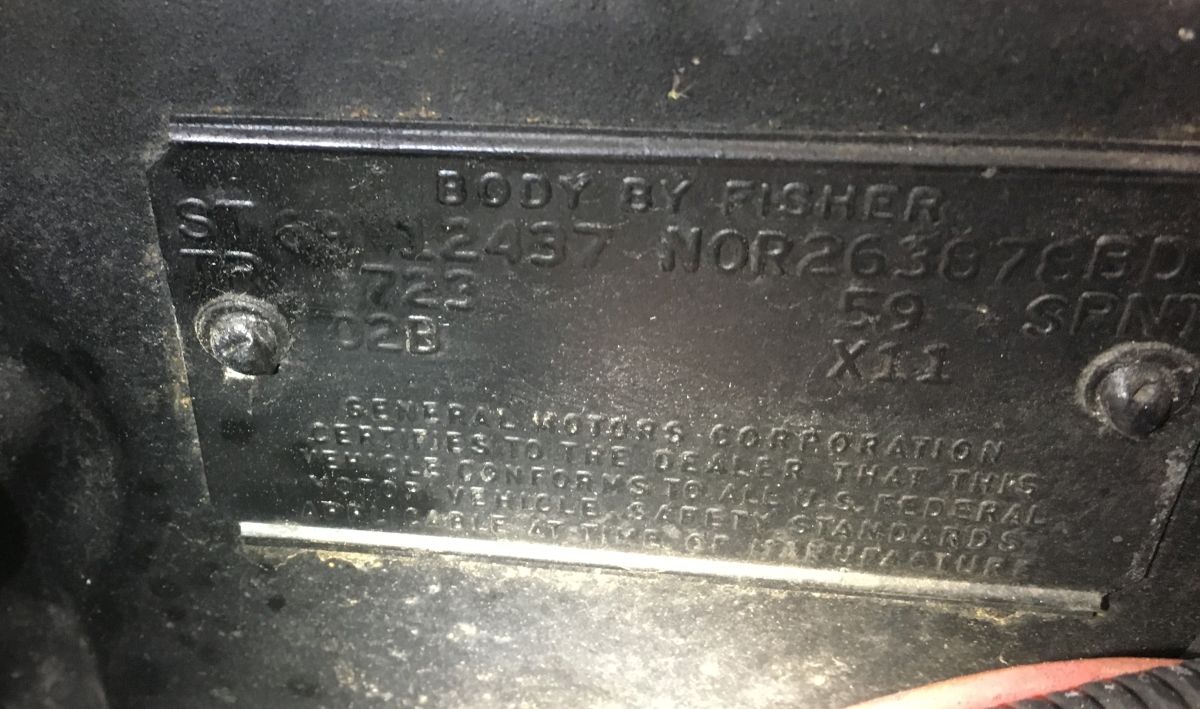

Here is a picture of the Data Plate anything on this help or hurt it?
I really do thank everyone for their help with this.

Can you post a pic of the engine stamp? If it's the original VIN stamped engine, suffix codes: HE, HB, HA would indicate L48 350 used in SS.

Post a pic of the entire underhood area. I'm betting it's not an SS.
