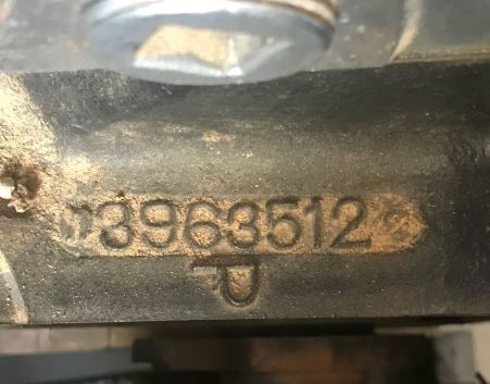

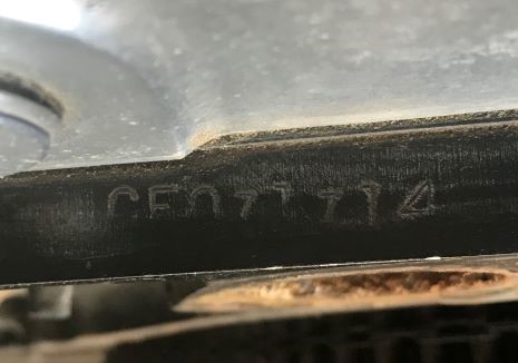

First 427 is definitely an L-88. Long block hasn't been apart. The pan was changed and confirmed to be 4 bolt mains. Block casting number is 3963512, heads are aluminum snowflake casting numbers 919842, and there is a block stamping on the pad in front of the head. The bottom 1/3 of the letters/numbers are illegible, but I believe it reads CE071714. The 7's sit a little lower than the 1s and the 4. The current owner indicated it came out of a 68 or 69 Camaro and that it was running when pulled. Currently no intake. Unfortunately I didn't get a picture of the date stamps on block or heads. I understand CE is crate engine, but any thoughts on the numbers after that? He asked me to make an offer on this one. I don't know what a fair price is for it.
