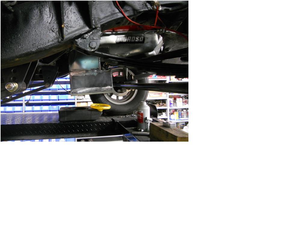

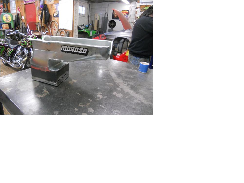

Default Extended oil pans
hi
my original 55 nomad gasser had an extended oil pan on it when drag racing back in the day with cooling tubes through it, but was rusted out on the bottom
so we fabricated another to the same dimension and it is on my gasser now
holds 10 quarts, but ensure you extend the oil pickup for the pump
i also ensured i use a HD high volume pump rather than stock configuration
thought you might be interested
thx
chris

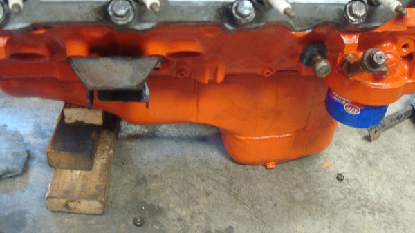

Here is one on a L88 I have. The engine was a over the counter L88 I do not know if it came like that or some one installed it after.
