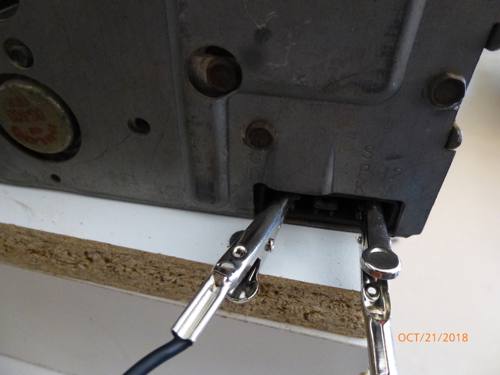

I am stumped. Not hard to do unfortunately.

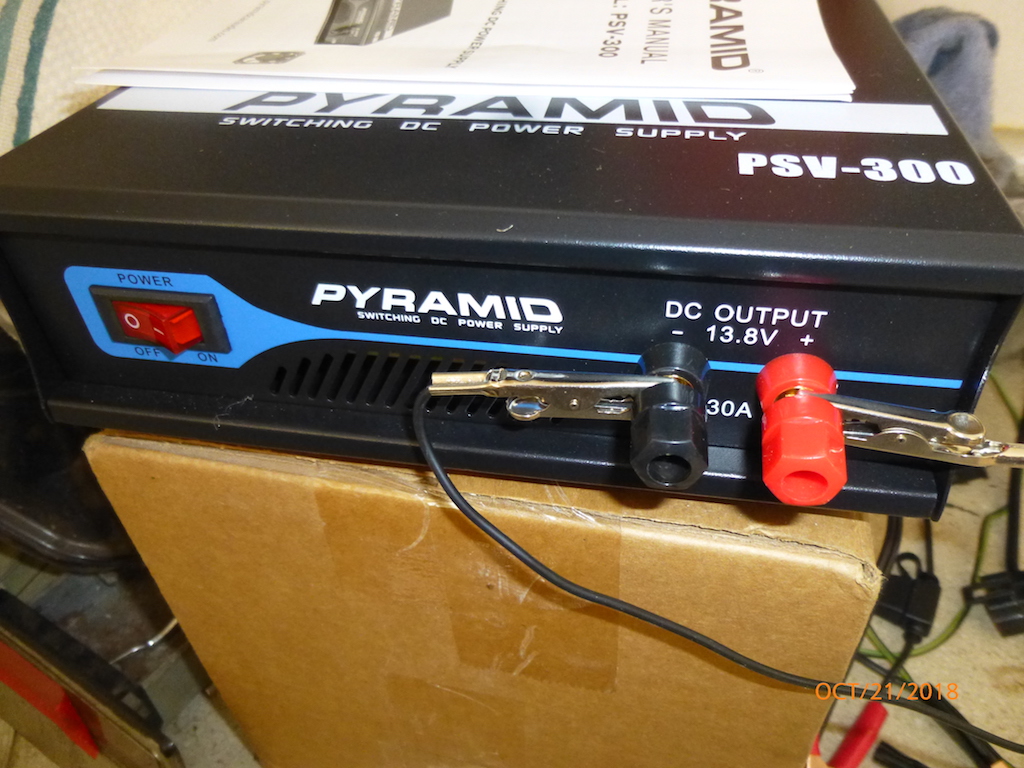

I bought a 30 amp power supply and have hooked it to the power terminal on the radio. Hooked a ground wire to the ground terminal and also grounded the speaker. I can't even get power to any of the radios I am trying to test. What am I doing wrong?
By the way I did have the power switch in the on position when I tried to test them.

Attach the ground clip to the radio case. I believe the ground your using is the speaker ground.

I tried that with no luck.

And your power supply is putting out 12 volts ~?
