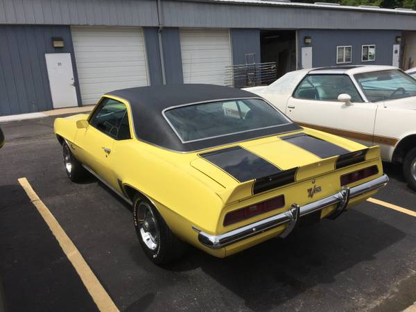

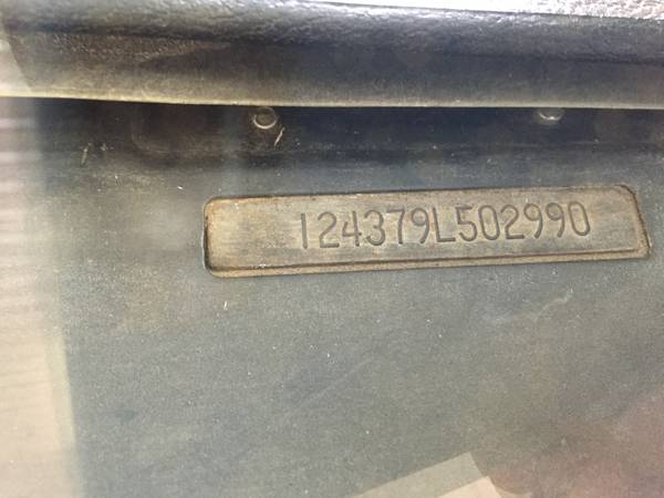

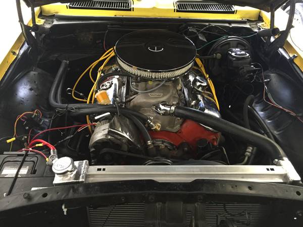

Motor is now a 396, but appears to be a LOS 76B trim tag. He claims it’s an original Z with factory endura, but I don’t see any mention of documentation? Neat car if it is what it’s supposed to be. I like to see the imperfections and minimal rust... wonder how old the paint might be?

Too early to have the ducted hood. Probably not a spoiler car (no emblem). If spoiler, it has the wrong one for that time frame. Too bad the real radiator is gone.....Joe
