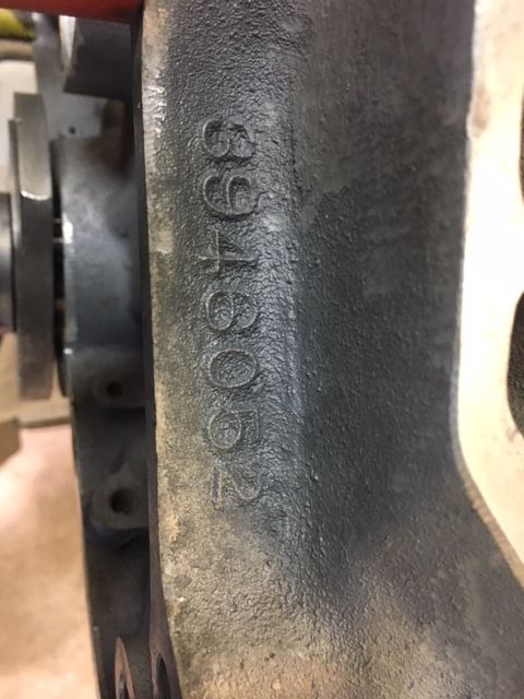

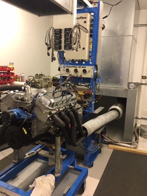

Another Original ZL/1 engine going together

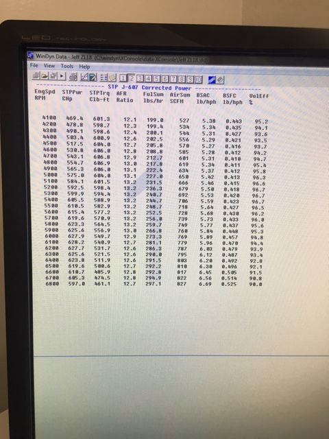

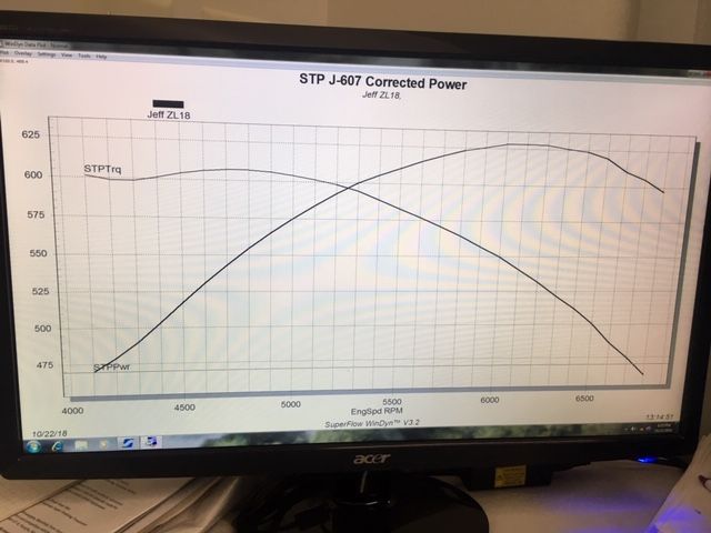

Dyno sheet

628 HP and 606 TQ ain’t bad at all!!

Man, that's nice! What is the compression ratio?

Stock 12 to 1 on VP 110 gas

Headers?
What Cam?

Congrats, those are huge numbers especially if stock heads and bore!
