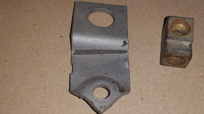

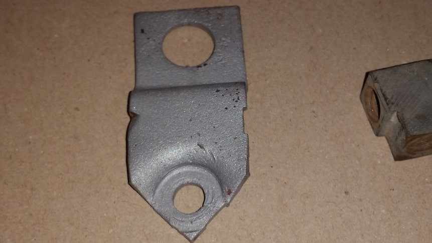

Need confirmation on this rearend bracket---
Is it for a 10 bolt rearend or 12 bolt rearend?
See pics below...
Thanks,
Sal

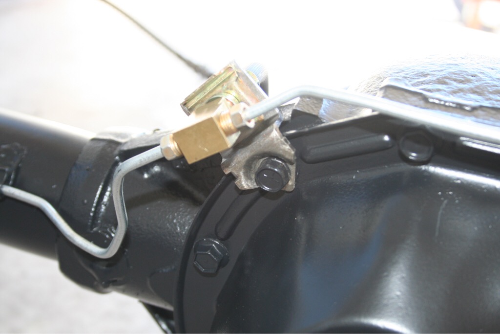

That bracket is used on my ’68 Camaro 12 bolt rear.
Bob

If you look closely the bracket you have on your 12 bolt is
slightly different----leading me to believe mine may be for a
10 bolt rear. Thanks.

----Not calling you out at all, but where is the difference? Yours is way more pitted, but that's all I can spot. Educate us please...…..Bill S

The raised area above the bolt is larger on Sal's and the offset is less (the bolt mounting surface and the valve mounting surface are in about the same plane).
