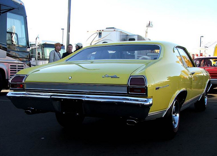

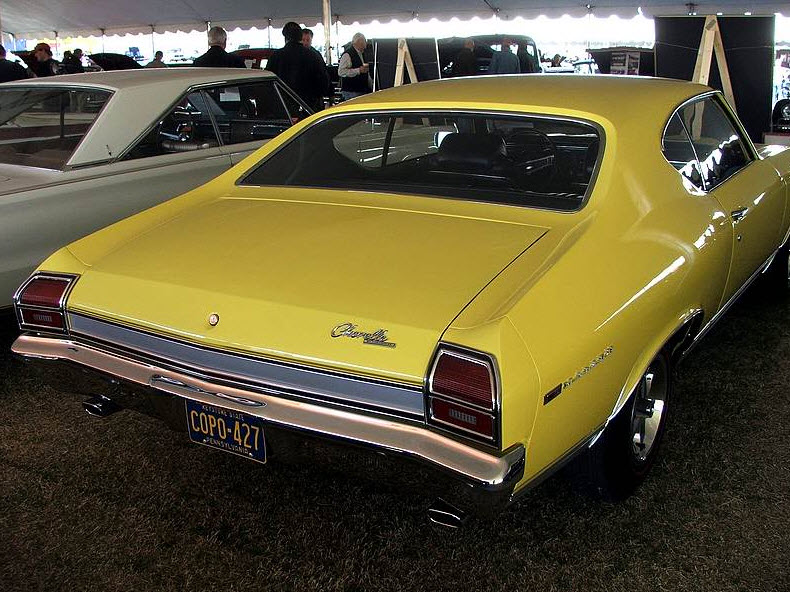

I believe there actually is one COPO 69 Chevelle that does have the Malibu exterior trim.
The car is Daytona yellow with a silver lower.
Rick
Yep! Cool car...

That yellow Malibu/COPO would be the ultimate Chevelle, in my opinion. Doesn't get any more rare than that. I would love to know if that was a factory mistake or if it was intended to roll down the line like that. I've seen several regular COPO Chevelles that had factory Malibu-emblem holes in the quarters that were welded closed by the factory and refinished.
