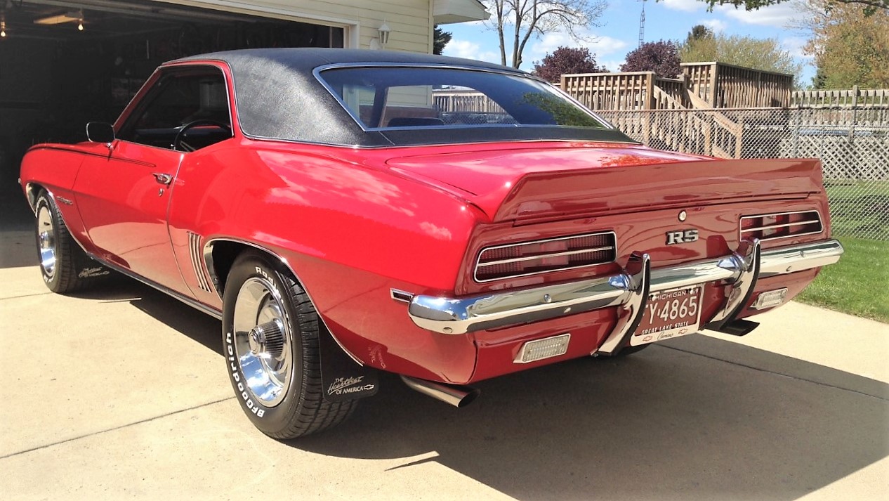

Hi
My BB 69 Camaro is saging on one side, Thinking of buying repo but assembly line look that Heartbeat city sells for $408.00 , Are these any good ?? Just wanted to get some input or is there another avenue I should go.
Thanks for your help.
Ken

Ken, I bought a set of assembly line/factory correct multi-leaf springs for my 69 Camaro from Heartbeat city. In my opinion they were worth the cost.

Ok, Thanks everybody for your help. I think I will go ahead and order a set , very good feedback. Tiger your car looks awesome, sits good too, not to high.
Thanks again.
Ken
