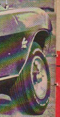

Should have stated "Wide Tread F70 x 14" which was one of the standard equipment Camaro SS tires.
From the May '69 Car Life test of an L78 Camaro SS.
