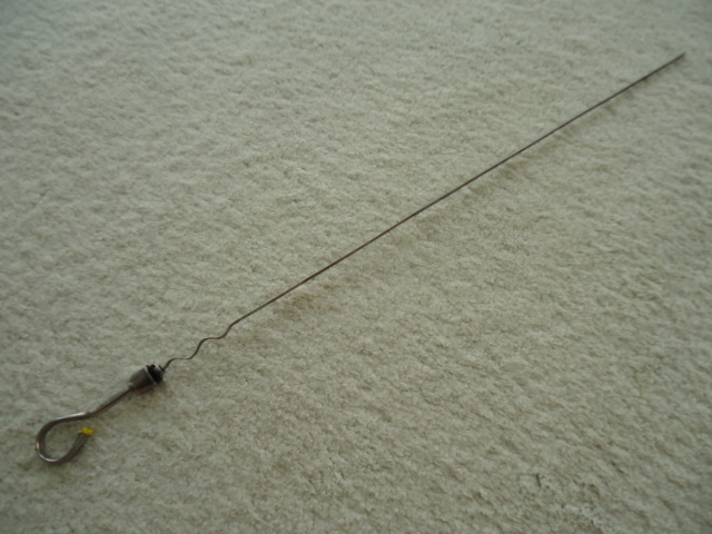

Ok member’s out there. What is the correct Oil Dipstick Handle.
Is it the Round Handle Yellow Tip or the Flat Handle Yellow Tip.
Any help would be greatly appreciated.
Thank You!

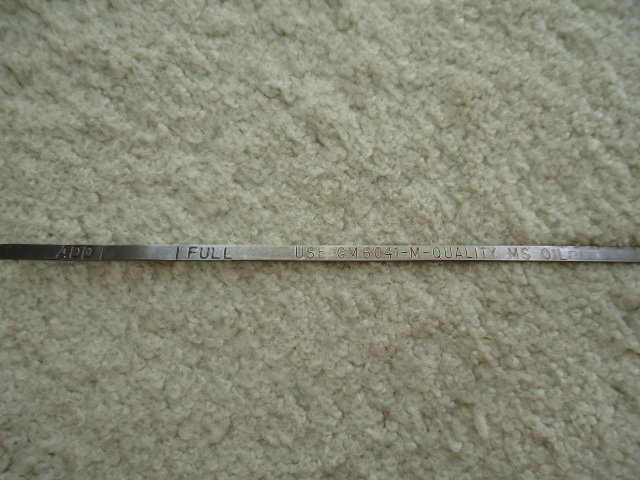

Flat handle...Part#3925599,installed on the assembly line as original equipment on:
1968 Camaro-Nova-Chevelle w/396cid.
1969 Camaro-Nova-Chevelle w/396cid. & 427cid.
1970 ALL vehicles w/396cid. & 454cid.
Measures roughly 24-1/4 long.
Shows USE GM6041-M-QUALITY MS OIL E near the bottom of the stick.
