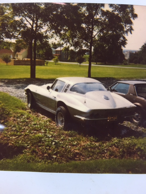

Like I said, I am away at school and don't get to work on the car very much, but when I do, things get done and it is so close to being roadworthy. I have attached pictures of the work going into the hood. The last picture is the end goal for the car to look like and sit like. I also found some old pictures of the car when it was first bought by my great uncle around the mid to late eighties. Sorry for the images being big, still getting used to posting.
