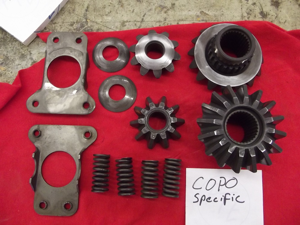

BE KQ specific, and the carrier is machined for larger thrust washers/spider gears.
Springs are wound in the opposite direction of the green 12 bolt spring. Side gears are 16 teeth vs 18 standard 12 bolt and are thicker than the 18 tooth. BE spider gears are larger and still have 10 teeth like the smaller 10 tooth standard 12 bolt. There are some comparison photos in some book I looked at once. I had posted on this before and can not find it.. ![]() Mike |

Thank you very much Mike. That is very helpful. Do you know how many clutch plates were used in these units? Was it 18 or 22?

I think it is the same clutch pack. And on the carrier unit it will be the same casting # but the pn# is different , and of course that is not on the carrier.
