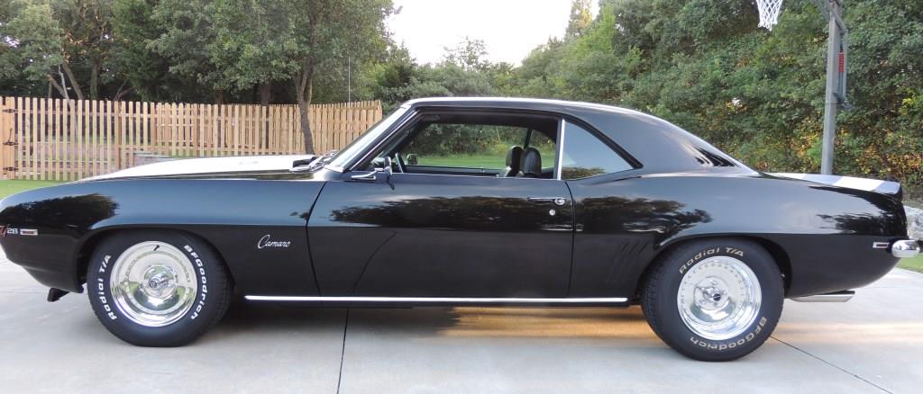

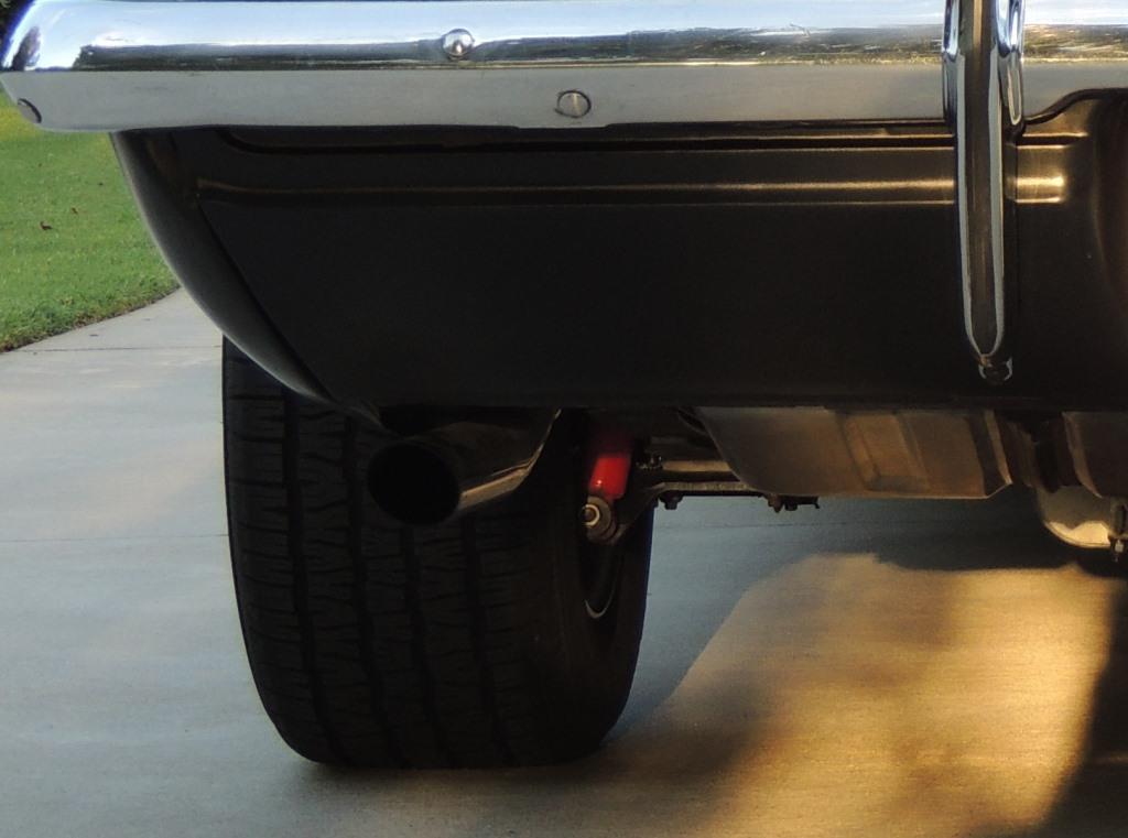

I have 255 60 15 on 15x8.5 Centerlines on the rear of my Z. I tried 275 60 15, and they did not hit the fender sitting still, but were way to close to risk driving. Pretty sure I would have burned some paint the first time I went around a corner.
Can post a pic tonight if it would help.
No rubbing. Stock wheel wells, no rolling of the lip.

I think 4.5, or something very close to it. I remember spending a lot of time getting what I wanted. Most of the off the shelf centerlines available were less than 4.
The YH ralley wheel is about 4.25 and is only 7 inches wide. To get the outer lip completely inside the wheel well, you have to have something over 4.25.
SOME 275 tires might fit. I wouldn't corner hard though. I had purchased a KILLER looking set of 275 Hoosiers from Eric at a very fair price, but was too scared of burning the paint. Probably would be OK for straight line. Sold them to remove the temptation. Didn't make any $$ on them, but they went to a good home. Of course a couple years later, I put some vintage Centerlines on my 68 El Camino, and 275's on a 15x10 fit great on that car.
You can see in one of these pics how close the wheel comes to the lower shock mount.

You are probably correct on the 4-7/8. I know it is really close to the shock mount. In fact, I have since put on a pair of traction bars (got tired of spinning the tires so easily), and had to bend the shock mount on one of the lower plates to get it to clear.
