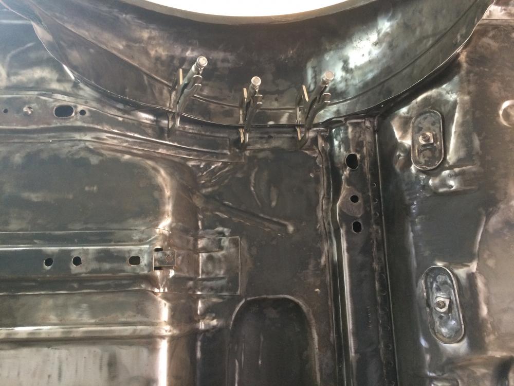

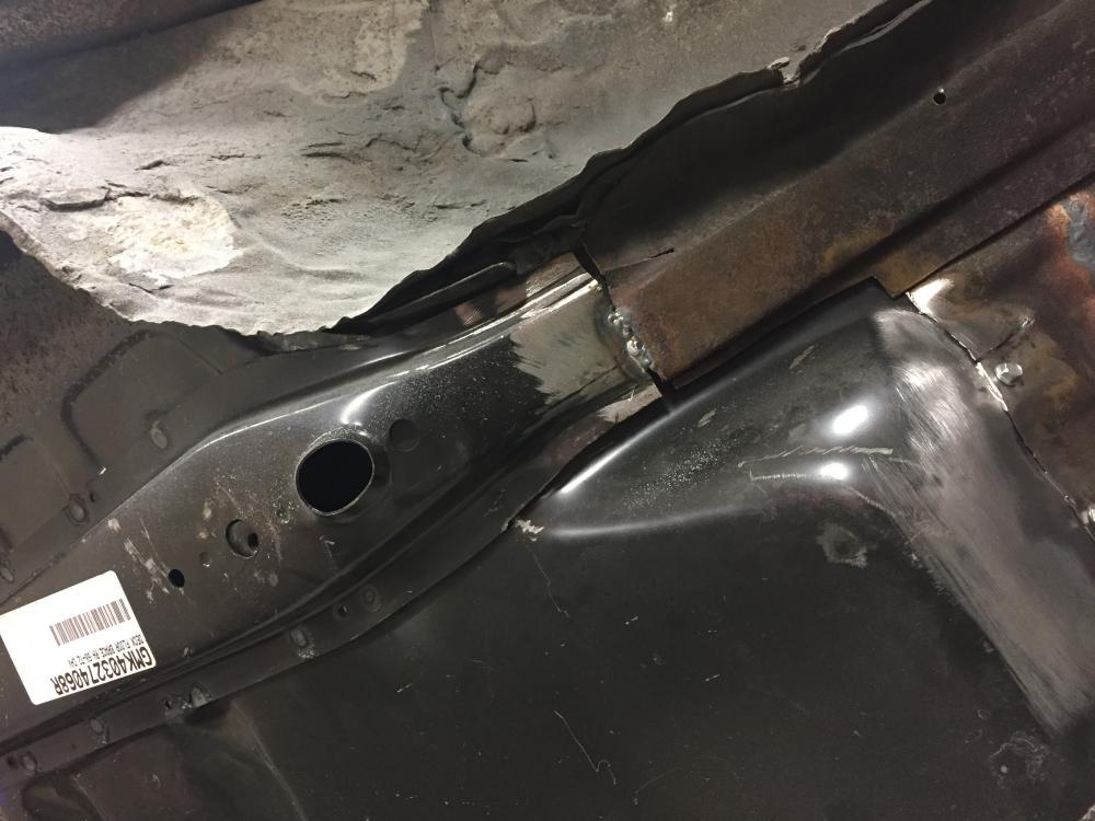

Has anyone ever attempted to replace an outer and inner wheel well with out removing the quarter? I have this GTO I'm working on (See Pontiac section) and the inner wheel wells weren't replaced correctly, another body shop hack job. He should have replaced the inners they are all beat up and I have no idea how?
You can kind of see it in this picture.

ive done it a few times..on the GTO it has a huge wheel house and plenty of room..the one place it gets tight is the rocker to the wheel house..i trim it down and weld it back together..it can be worked and become an unable to be detect repair..it just takes time and patience....just make sure ya get some body cavity wax in there...
put the outter in place and slide the inner in dont weld anything til its all in there..and prep it 100% like youre ready to weld it before ya start sliding it in there..cuz it probably isnt comeing back out easy..
to remove, work on the inner first and get it all the way out by cutting it up etc.. and pie cut the thing to get the outer out...
the repop outers do not fit with out some work on a GTO..pretty sloppy....so it just doesnt fall in place, but its very usable and workable..it takes 2 days to do the first it seems, and then the second is just a few hours..
any competent body man can do it..IF you pay them enough to do it right..

Ok thanks guys I'm going to attempt this. I got a little bit more info on the car it was hit on the passenger side rear quarter, that is one reason the inner is all messed up. The main reason I am attempting to replace it is because the pass trunk hinge support that hooks to the inner is all messed up from the accident. I will remove the inner then the outer which will be simple since the previous guy hacked it in there. Worse case I will have to take the quarter back off. I think I can do it.

Done, it actually took more time to get them out then to replace. They went in very easy. First install the outer then the inner. I have the car on the rotisserie which made it very easy for me. Once the outer is installed, start the inner at the rocker and slide it around to the back of the wheel well. I actually took them in and out a couple of times once I had a system.
