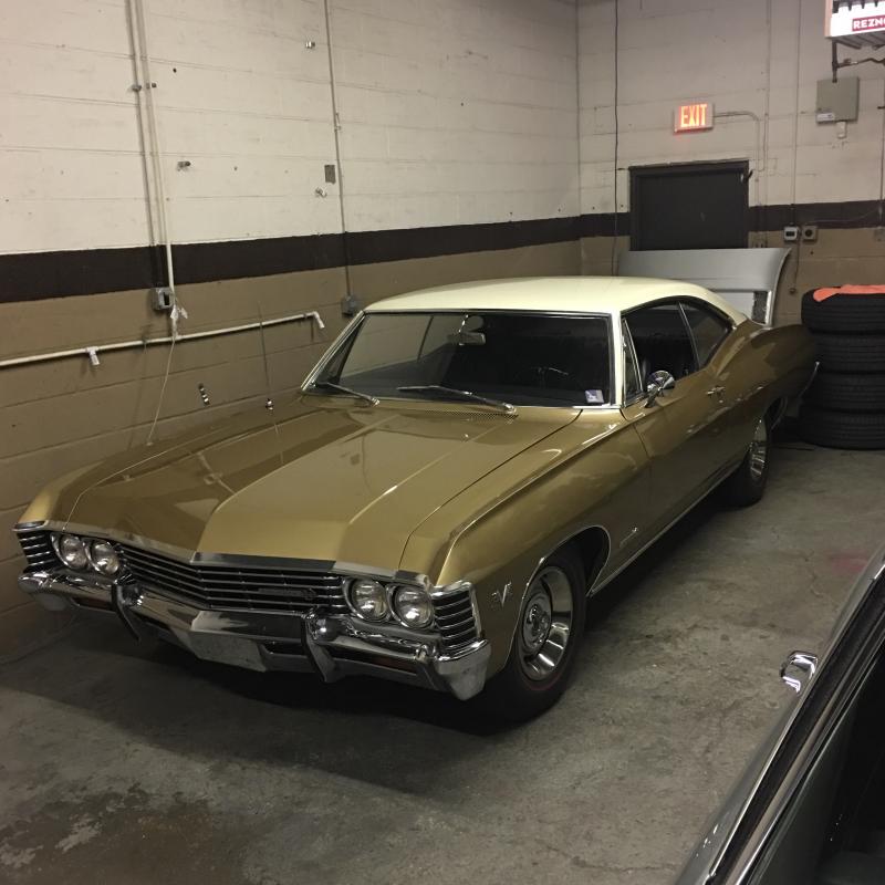

So picked up this 57k orig mile impala ss 396 car and decide to build a factory sleeper here are some pics of the build I finished this car in 5 weeks and drive it weekly hope you guys like

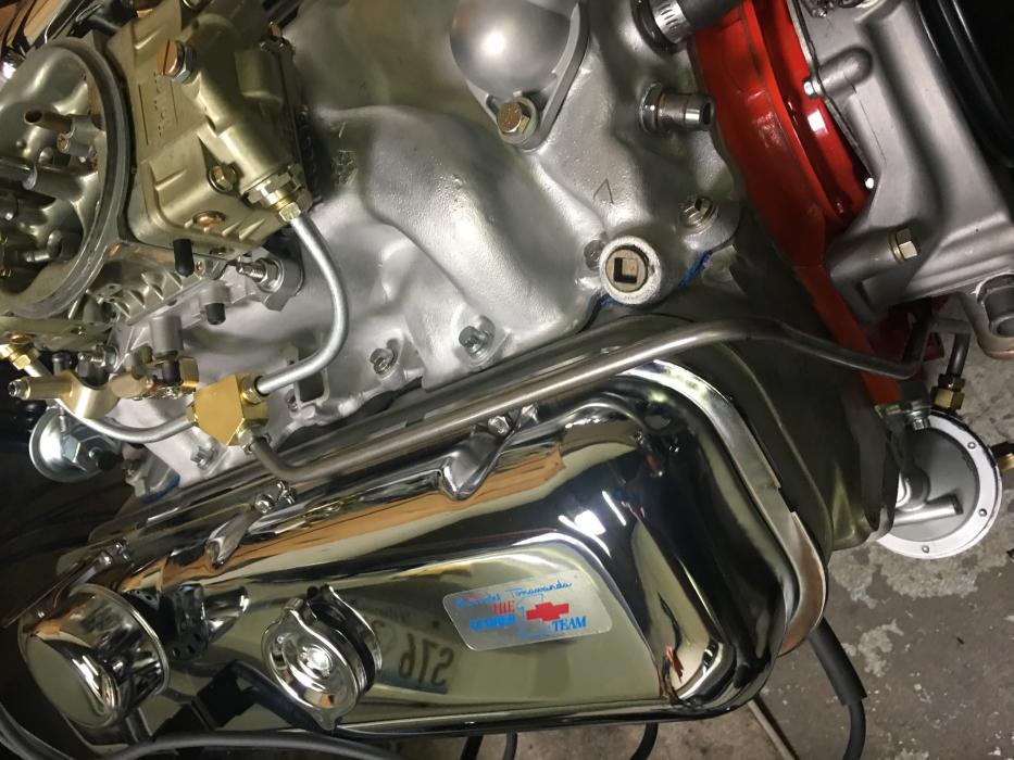

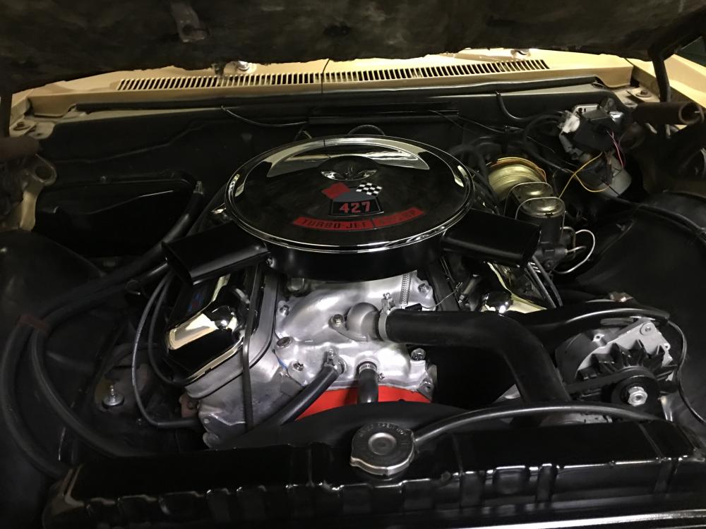

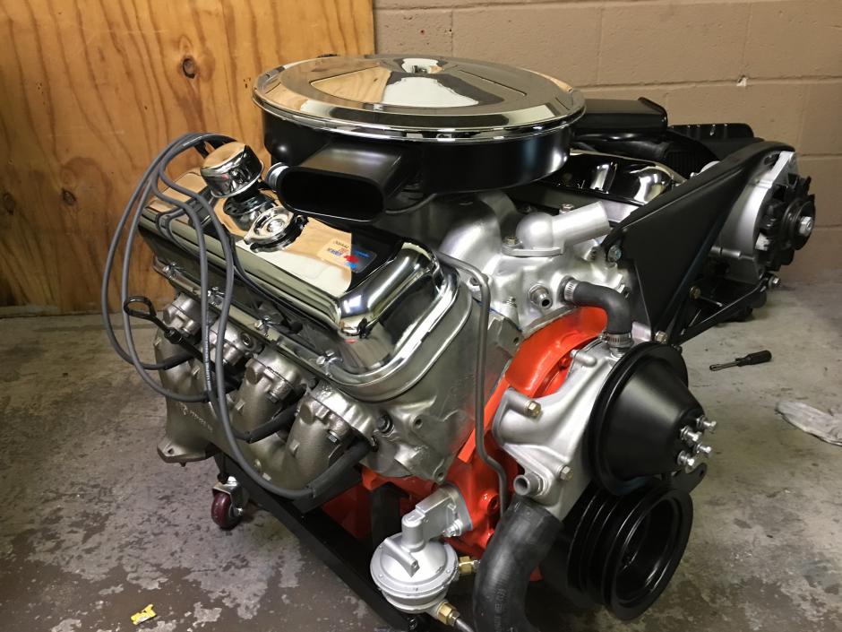

Built this 496 as a L88 clone with orig. 074 heads and matching intake solid roller cam pertronix distributor and coil dynoed at 598 hp and 600 ft on pump gas

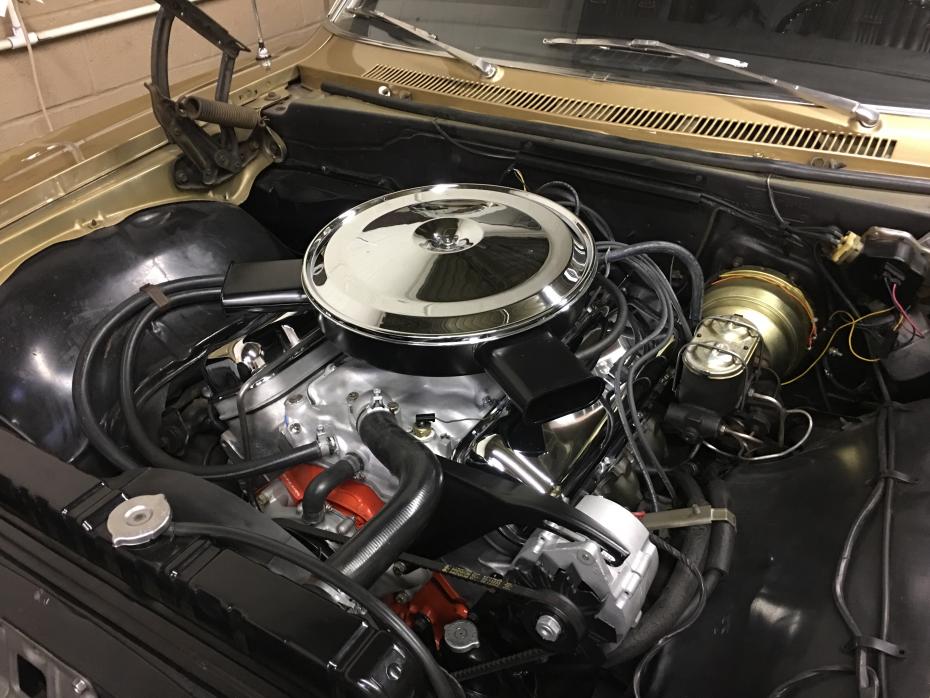

Restored all the factory brackets etc... from the orig 396 but had to replace the brake booster due to clearance issues trying to keep a orig look

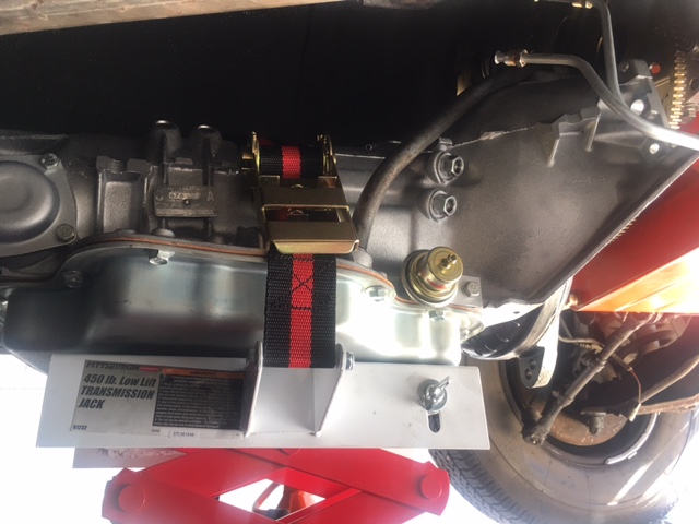

Replaced orig numbers 400 trans with a mild built one and a custom billet convertor along with a new driveshaft. The factory 12 bolt had a eaton posi with 2.73 gears so I installed a Yukon posi with a 3.55 gear set.

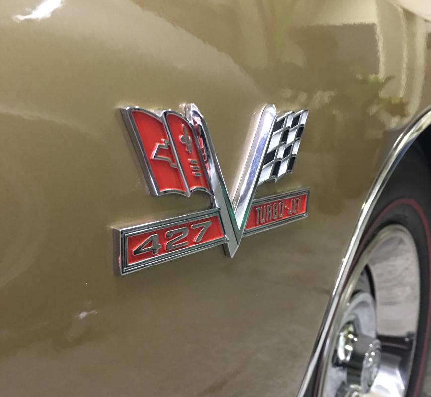

Added the 427 badging
