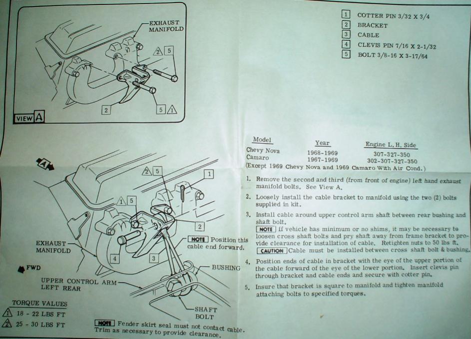

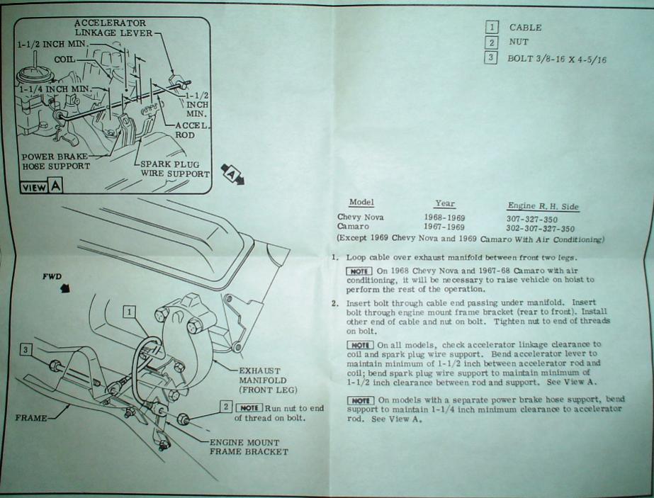

I know a retired mechanic from Ed Stinn Chevy who installed lots of these safety cables. He said they only installed them on the drivers side due to the way the motor would torque in drive..

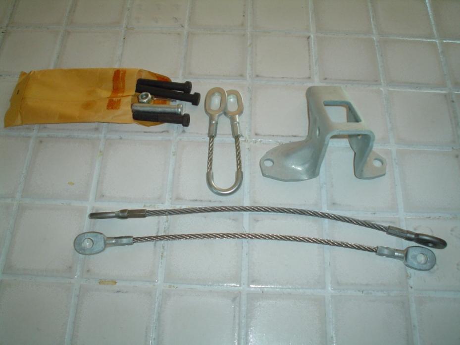

The cable....

I love the part about the fender skirt.. "Trim as Necessary to provide clearance"
Seriously, I recall the use of cables, and even chains, (hardware store stuff) especially before the recall part was widely provided by GM.
