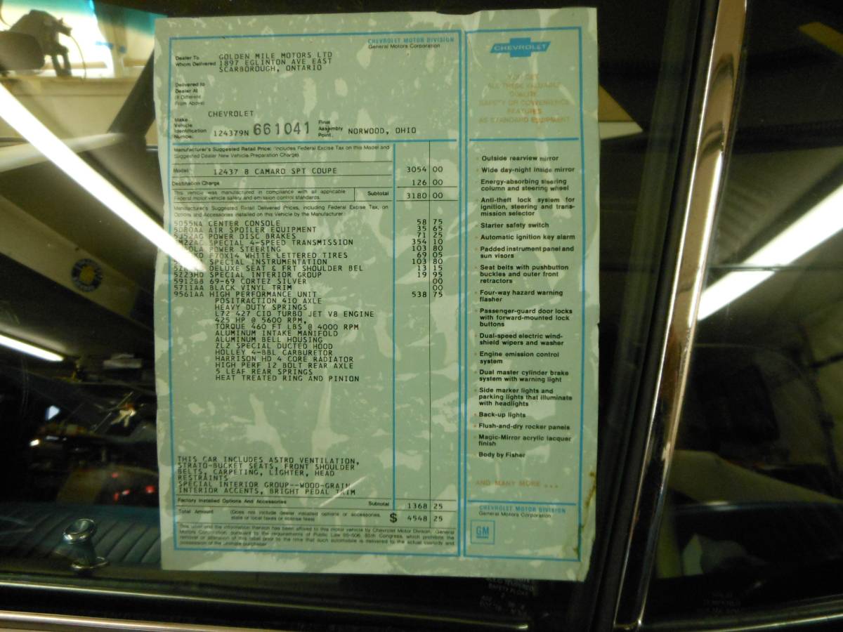

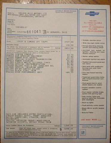

Subject VIN 124379N661041
Reported rebody as info @ 1'st link below but any ever ads seem to tout originality?
Copo Connection paperwork also "sensitive restoration" mentioned in description at 2'nd link.

VIN 124379N661041 - Rebody?
Trim Tag Body # NOR35147(2-4?)
Camaro COPO 9561 AA
Cortez Silver - 711 Black
L72 M22 D55 D80 G80 G84 PL5 U17 ZL2
Shipped June 25/69
Delivering dealer - Golden Mile Chev/Olds Toronto

Nothing like having two different Window Stickers made for the same car.
