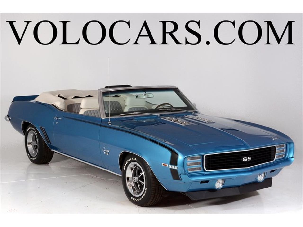

http://www.volocars.com/vehicles/137...maro-rs-ss-396
Does not look like a great restoration that would please most here, but if its real, and the docs are real, its cool to see a Chicago car survive the rust, and still be in Chicago. Only posted as its an RS and its got docs and its a 4spd.

I would be suspect u could,nt get houndstooth in a conv it was not avail except in the pace cars only....It just didn,t hold up in a conv......

Hate to be a wet blanket, but....
I am not liking that trim tag at all. And, as Scott mentioned, houndstooth wasn't even available in verts other than pace cars.
Why is original owner's name and address smudged out on the POP (two places) and the sales contract?
Very late car; shouldn't an L-78 have an 8000 tach?
Front subframe horribly dented, which is common, but should be corrected on a high dollar car.
Deep rust pits on the firewall were just painted over.
CAUTION fan sticker?????

I'd be very skeptical...could not get convertible in the houndstooth interior except the orange houndstooth in the Pace Cars...."window sticker" states white houndstooth interior...no pic of trim tag...I'd say it was recently built to be pretty.

Tag:

Repop tag. Lynn you forgot the cheap ass chi neeze booster.... [img]<<GRAEMLIN_URL>>/sick.gif[/img]

Lotta lipstick on this one. Pretty, but not at that price. Sheesh.

Darn oldtimers disease. I wasn't even sure on the booster, but figured that's what it was. Looks like a total &quot;put together&quot; mutt with fake tag, fake docs, and HUGE profit margin.

That's a terrible repo tag..
