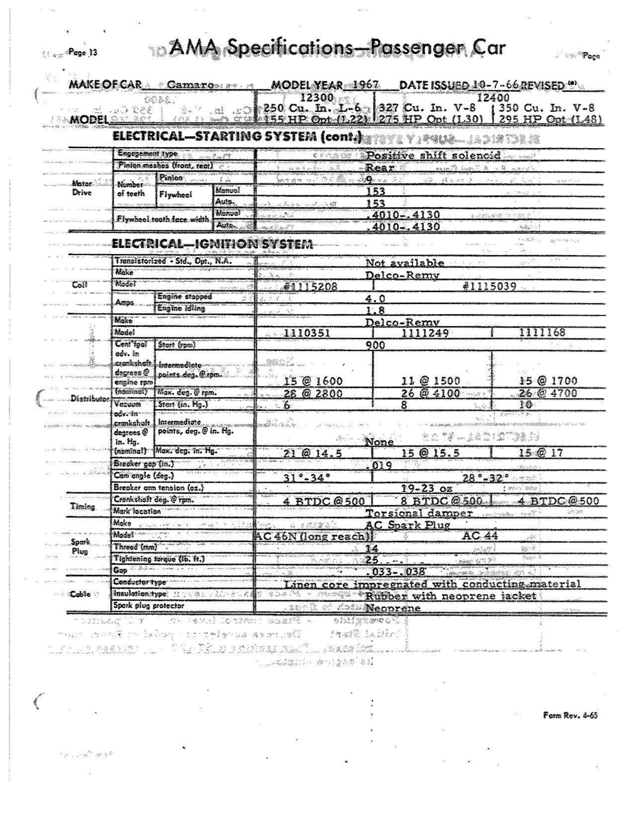

I'm having some trouble determining what is the correct coil for my 11B NOR 1967 Convertible. The car was assembled on Nov 11, 1966, and has a Tonawanda L30 327/275 with an 039 stamped (1115039) coil. I've owned this car since 1978 and the coil and correct bracket look completely original. Car seems to run fine with this coil.
I can not find any data on the 039 coil in the usual places such as parts books, Delco literature and internet searches. Does any one know what is the correct coil for this car and engine or have any information on an 039 coil?
