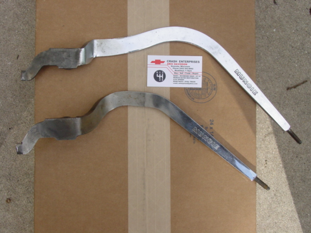

you ever see a shifter and ball like this?
no muncie on it just a T and the ball looks marbleized.

Maybe a Saginaw shifter. Never seen a ball like that....

I have seen that 'T' marking before...Saginaw 4 spd. I think we have a console version with the same mark. Low horsepower V8 applications got the Saginaw wide ratio tranny. Limited audience for that item..

I had a 72 SS 350 El Camino with a Saginaw and that stick.Do not recall which ball it came with.
Swapped it out for a M-20 and a Hurst.

Tom, how do you tell the difference between a console shifter and a non console?

The biggest difference is the physical size of the shift handle....the bench seat unit is longer and taller. Console shifter will have a more upright aspect to the handle to make it work with the console setup.
I believe the spring attaches to a tab that is mounted on the driver's side exhaust head pipe to manifold connection...that's how it is on the BB cars.

Donnie...The console shifter kicks the handle over to the right so it comes up thru the center of the console. The non-console shifter is more straight up and comes thru the floor closer to your leg.
