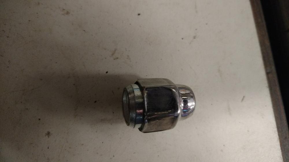

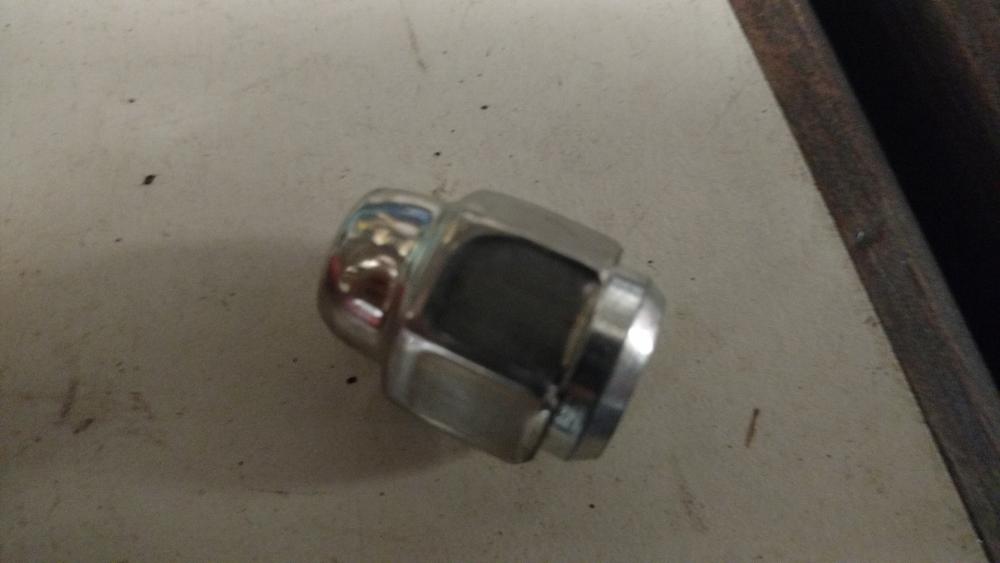

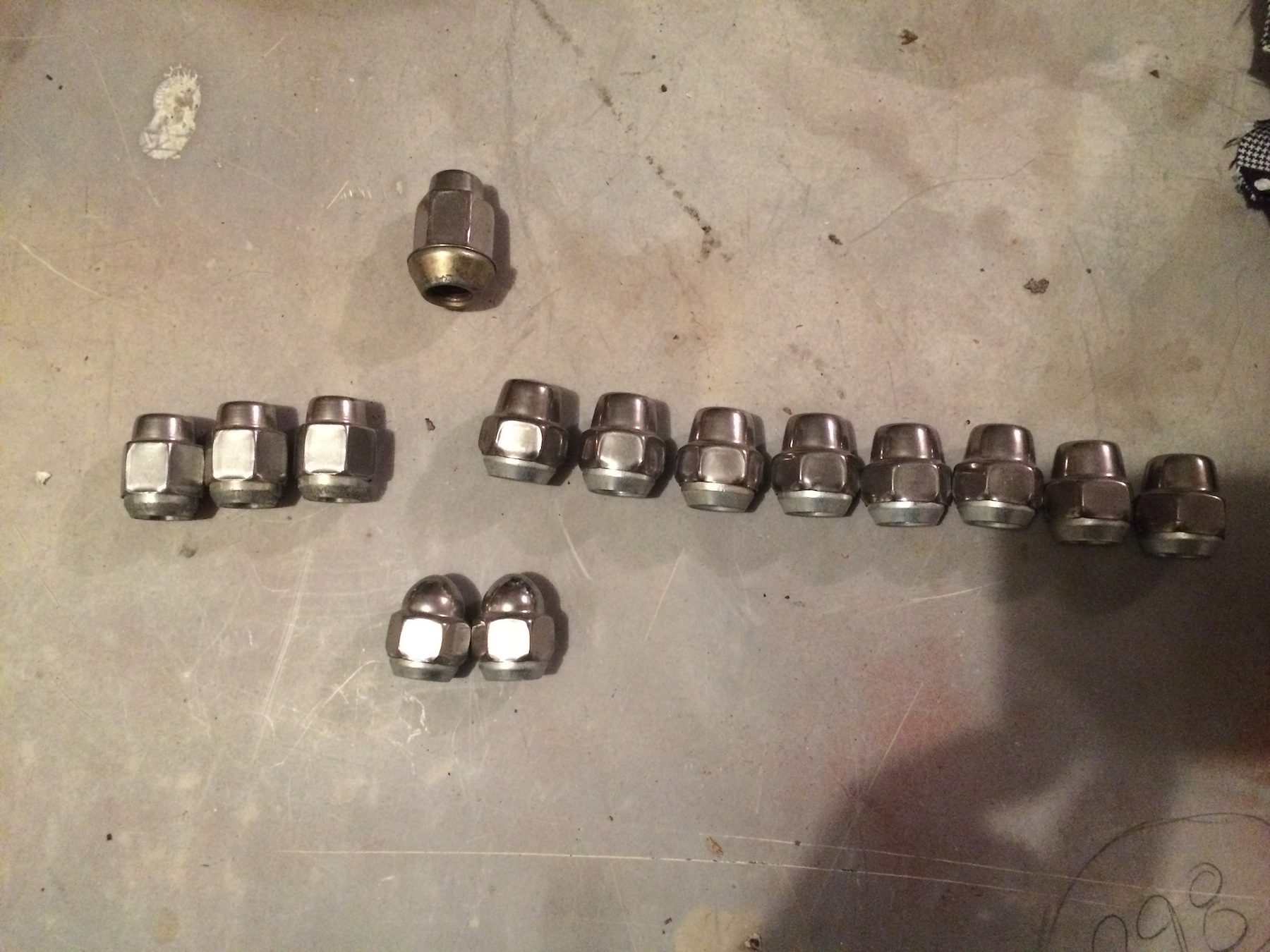

Who makes correct lug nuts for the SS wheels theese I have the taper is so small they look like they will enlarge the holes even on a good rim

I just recently ruined one wheel and slightly opened up lug holes on another due to the same cheap-a$$ repro lug nuts [img]<<GRAEMLIN_URL>>/mad.gif[/img], so I will be interested in replies to this too, John. That tapered section is definitely smaller in diameter than the original GM lug nuts.

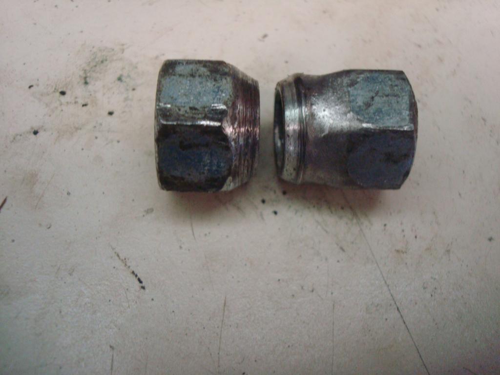

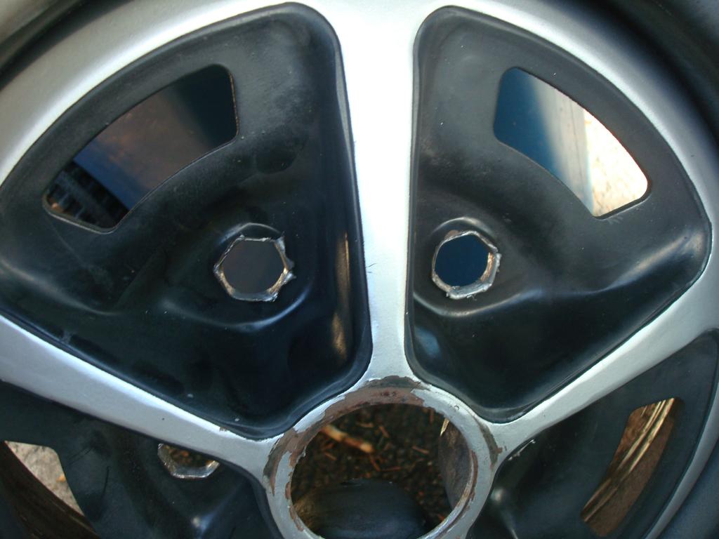

I would like to see what a original lug nut taper looks like. Here is what happens when you use the cheap ones. Even on a perfect rim the taper is to small fot the taper in the rim.

John -- did they &quot;bottomed out&quot; against the drum/rotor without tightening the wheel? TAZ [img]<<GRAEMLIN_URL>>/dunno.gif[/img] [img]<<GRAEMLIN_URL>>/thumbsdown.gif[/img]

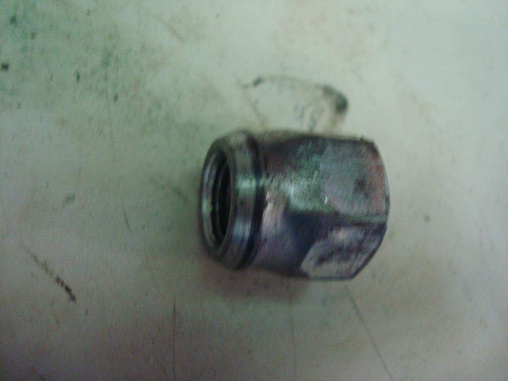

It is not my car some body else put the wheels on and when it fell off they called a tow truck. The tow truck driver put the spare on to get it on the truck he did say the lugs were tight when he took them off. The guys who car it is had some extra repop lugs in the trunk and as I was putting them on a perfect rim I ca feel it pulling thru the lug holes. I bought replacement lugs at Oriely and put them on but they do not have the stainless steel cap. side buy side the repop lug and a original rally wheel lug nut I would think the SS wheel and a rally wheel would have the same taper

Yep, that's pretty much what my wheel looks like too. I had the repro lug nuts on for over a year with no issues.....then I had a posi differential installed and took the car out to make sure the new posi was working as it should [img]<<GRAEMLIN_URL>>/[/img] Soon afterwards is when the rear wheels loosened up and almost fell off.
