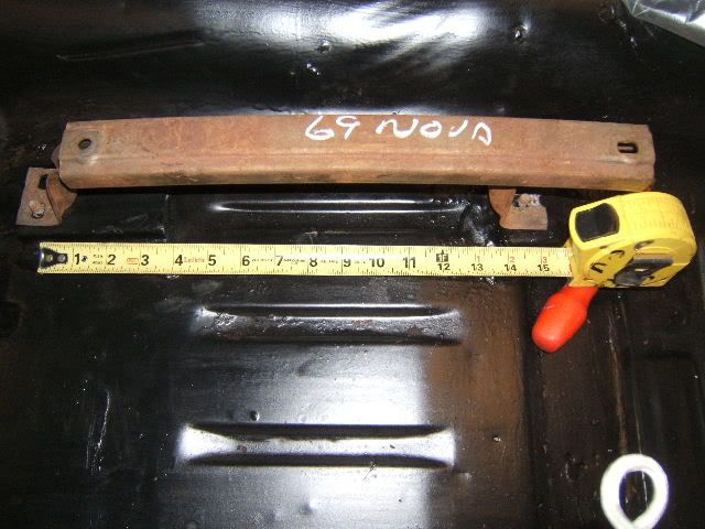

I'm also looking for a nice clear picture of a 69-72 Nova floor pan from inside the car, with the carpet removed so I can see the placement of the bucket seat brackets welded to the floor. I have the brackets, but the 2 pictures I have aren't clear enough to see the bracket details.

I do have those pics on file Steve. They aren't clear enough to see where the small outside seat brackets go. I thought someone might have a good pic of a clean bare floor that would show it more clearly.
<div class="ubbcode-block"><div class="ubbcode-header">Originally Posted By: Mr.Nickey Nova</div><div class="ubbcode-body">Bill, i know where you are coming from for i also have had two lower back surgeries myself in the last 20 years. I have two Novas with bench seats also, which i drive about 300 miles each a year. I don't plan on making any changes to the seats for that is the way they came when new. Maybe you can have the front bench refoamed to make it firmer to give yourself extra support. I'm with Dan &amp; Sam on this one, car looks great the way it sits. </div></div>
The bench seat is actually pretty firm for a bench seat. The problem is the angle of the back in relation to the seat. Plus bench seats give no support when flying around corners, I tend to slide across the seat....lol... Maybe I'm too use to being glued to the seat in the Corvette. Thats the position I'm looking for. I can drive the Vette all day long and not have a single ache when I get out.
Still looking for a pic of a clean/blasted/painted floor. Just not sure where the 4 small seat track brackets go. I have most of the parts to do this conversion. I'm still driving the car. As soon as the snow starts flying, I'm planning to do this project. I guarantee it will come out the way I want it to look, otherwise, I wouldn't do it, or spend the couple thousand dollars in parts.

Bill having a nova with bucket seats IMHO isn't going to make you back issue any better. This is one of the main reasons I sold my 68 L78 nova with bucket seats. I was very uncomfortable driving the car. Not enough leg room for me and if I was in the car driving for a short period of time I could barely walk when I got out. The nova seats sit up high for me being 6'3 my head and leg room was limited. But I think this is what you are looking for? You know 68-71 nova bucket seat brackets are nova only, chevelle bucket seat tracks are longer.
