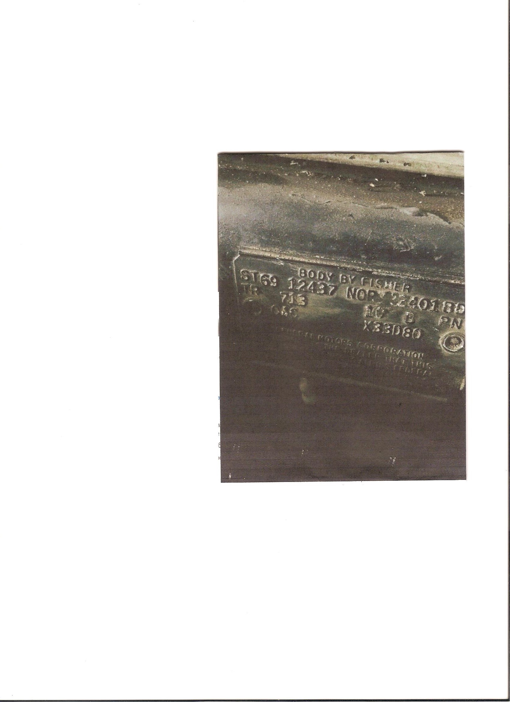

I was checking out a 69 Z28 Camaro and the trim tag had a build date stamp of 04C, also had X33D80 stamp. Isn't that production date of 04C a bit early for the D80 stamp ?

Yes it is. Do you have a picture, or at least the body number?

trim tag picture

Reproduction tag, new rivets never Pierced

I thought so, triple black is one of the more desirable combo's out there, to good to be true.

I saw that...purposely sketchy ad IMO..."I found an old car in the barn and don't know what it is"

Agree that it looks to be a repro trim tag.
Nice patina though?

I believe 5D is the start of D80 on the trim tag.
